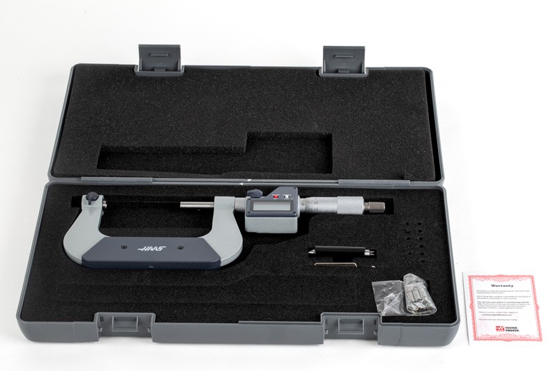

50-75mm (2-3") Digital Screw Thread Micrometer, Non-Rotating Spindle, 0.001mm (0.00005") Resolution, 0.01mm Graduation
Part #: 09-0236A
DIG THREAD MIC,50-75mm/2-3", 0.01mm, NR
Price: 440.95 ( / unit)
Price: 11023.95 ( / unit)
Price: 3280.95 ( / unit)
Price: 1984.95 ( / unit)
Price: 4629.95 ( / unit)
198.97

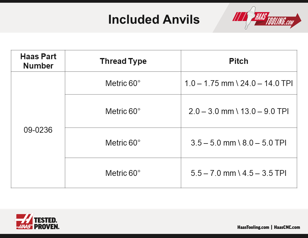

Screw thread micrometers are used to measure the thread pitch or threads per unit length of screw threads. This micrometer features a metric thimble graduation, digital screen, stainless steel anvils, and a stainless steel, non-rotating spindle. Included anvils can be found in chart below.
