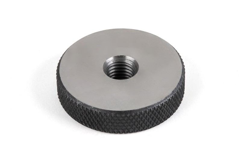

5/16"-24 UNF-2A, GO Thread Ring Gauge
Part #: 09-0510
THREAD RING GAUGE,GO,5/16"-24UNF
Price: 37.95 ( / unit)
22.97
This 5/16"-24 UNF-2A GO thread ring gauge is a precision tool used to check the external pitch diameter and thread quality of external threaded part by threading the gauge onto the work piece to verify if the threads meet the required tolerance specification.
Type Thread Ring Gauge
Thread Size 5/16"-24
Gauge Type GO
Thread Series UNF - Unified Natl. Fine
Thread Class 2A
[TPI] Threads per Inch 24 tpi
Thread Tolerance ± 0.00016 in
Rockwell Hardness 58.0 - 63.0 HRC
Material Hard Steel
Standard ANSI B1.2
Inspection Report (Y/N) Y
