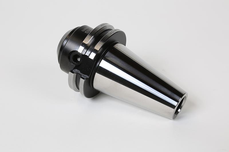

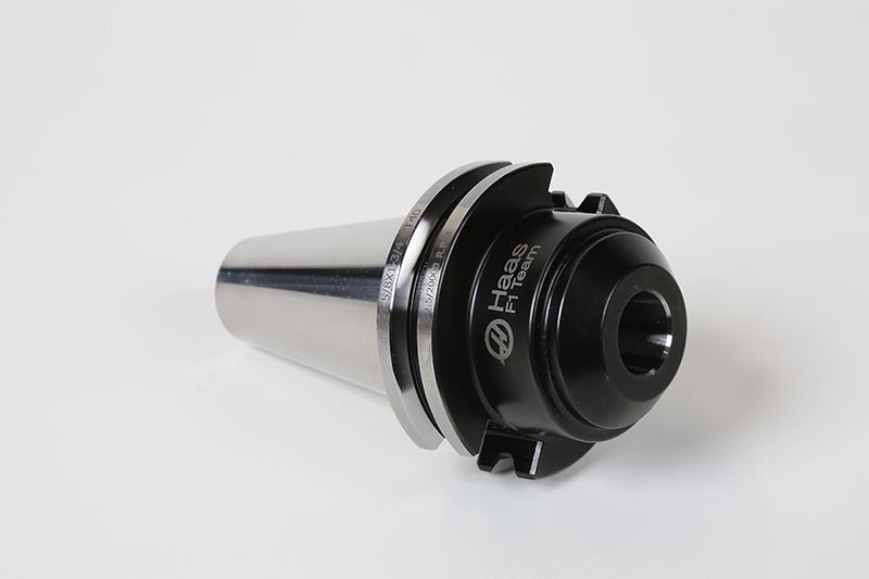

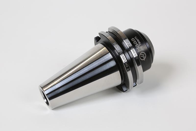

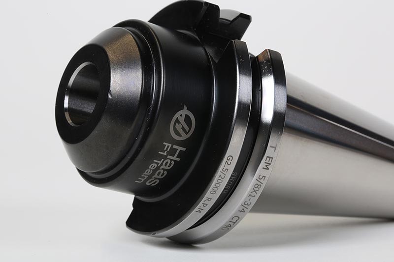

CT40 5/8" End Mill Holder x 1-3/4" Gage Length, TSC
Part #: 04-0005
CT40-EM-0.625-1.75
Price: 69.95 ( / unit)
38.97
This CAT40 end mill holder has a 0.625 in \ 5/8" bore diameter and a 1-3/4" gage length. It uses the Weldon flat standard with side-lock clamping for secure clamping of cutting tools. It is through-tool coolant (TSC) capable, with a 5/8"-11 pull stud/retention knob thread.
Taper CT40
[ØD] Bore Diameter 0.625 in \ 5/8"
[ØBD] Body Diameter 1.5 in
[ØBD2] Minimum Body Diameter 1.0 in
[GL] Gage Length 1.75 in
[BL] Body Length 1.0 in
[ØD2] Shoulder Diameter 1.75 in
[SH] Shoulder Height 0.63 in
[TP1_L] Thread Location 0.938 in
[TP1] Thread 1/2"-20
Concentricity 0.0002 in
Balanced to RPM 20000
Bore Tolerance H5
Retention Knob Thread Size 5/8"-11
Through Tool Coolant Yes
Spindle Drive Slots Yes
Weight 2.3 lbs \ 1.1 kg
