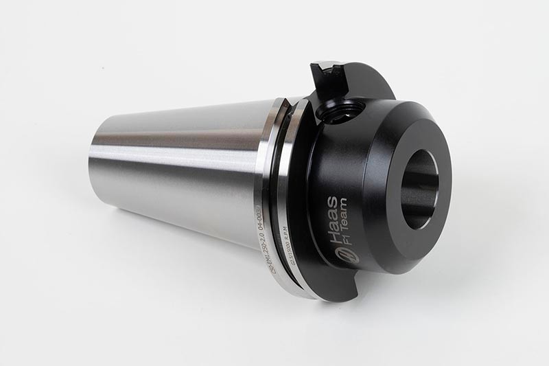

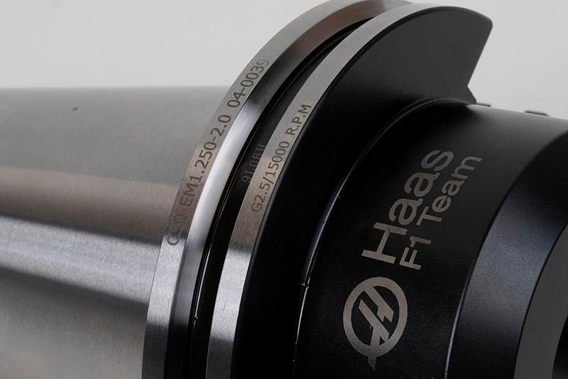

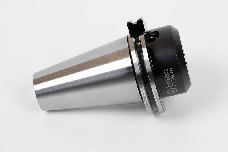

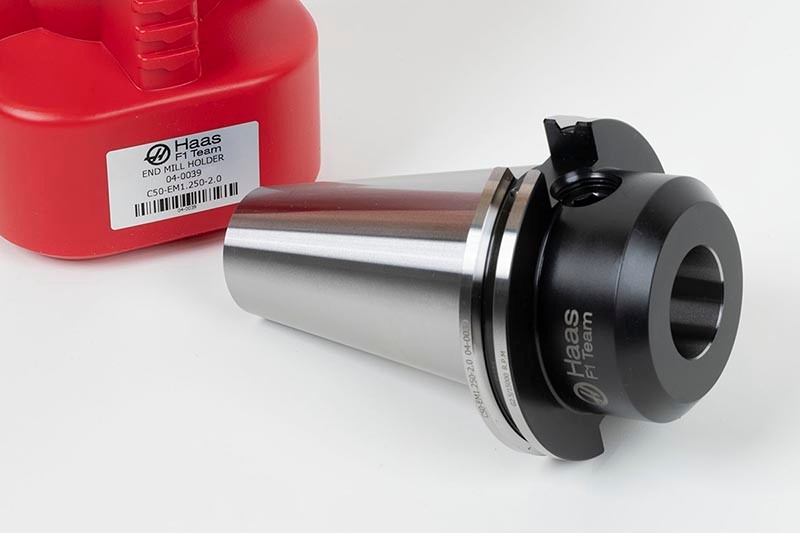

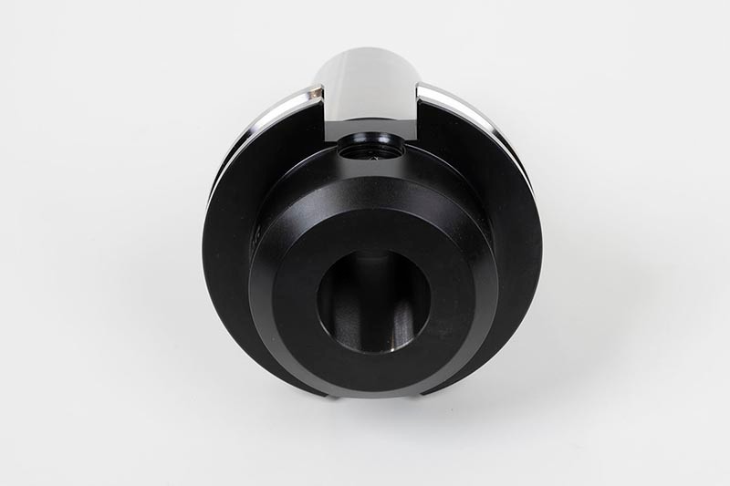

CT50 1-1/4" End Mill Holder x 2" Gage Length, TSC
Part #: 04-0039
CT50-EM-1.25-2.0
Price: 103.95 ( / unit)
67.97
This CAT50 end mill holder has a 1.25 in \ 1-1/4" bore diameter and a 2" gage length. It uses the Weldon flat standard with side-lock clamping for secure clamping of cutting tools. It is through-tool coolant (TSC) capable, with a 1"-8 pull stud/retention knob thread.
Taper CT50
[ØD] Bore Diameter 1.25 in \ 1-1/4"
[ØBD] Body Diameter 2.75 in
[ØBD2] Minimum Body Diameter 2.0 in
[GL] Gage Length 2.0 in
[BL] Body Length 1.25 in
[TP1_L] Thread Location 1.125 in
[TP1] Thread 3/4"-16
Concentricity 0.0002 in
Balanced to RPM 15000
Bore Tolerance H5
Retention Knob Thread Size 1"-8
Through Tool Coolant Yes
Spindle Drive Slots Yes
Weight 6.8 lbs \ 3.1 kg
