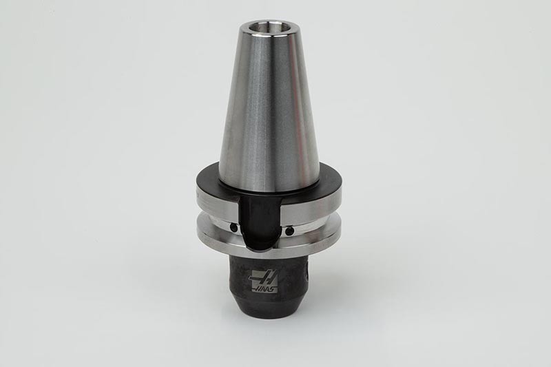

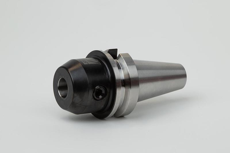

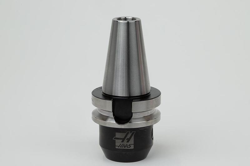

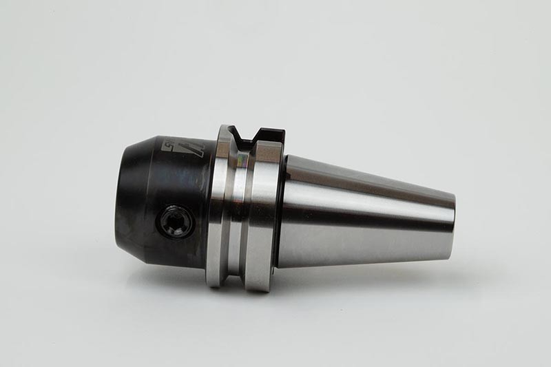

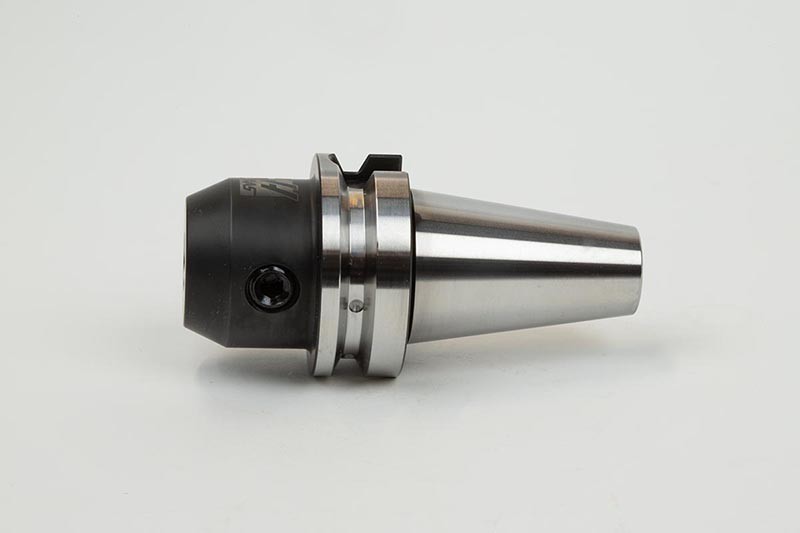

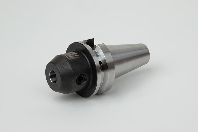

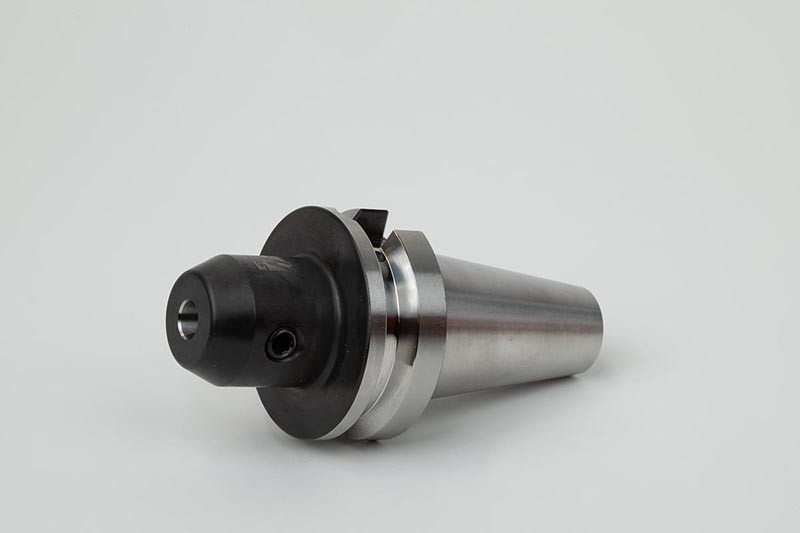

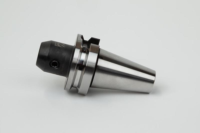

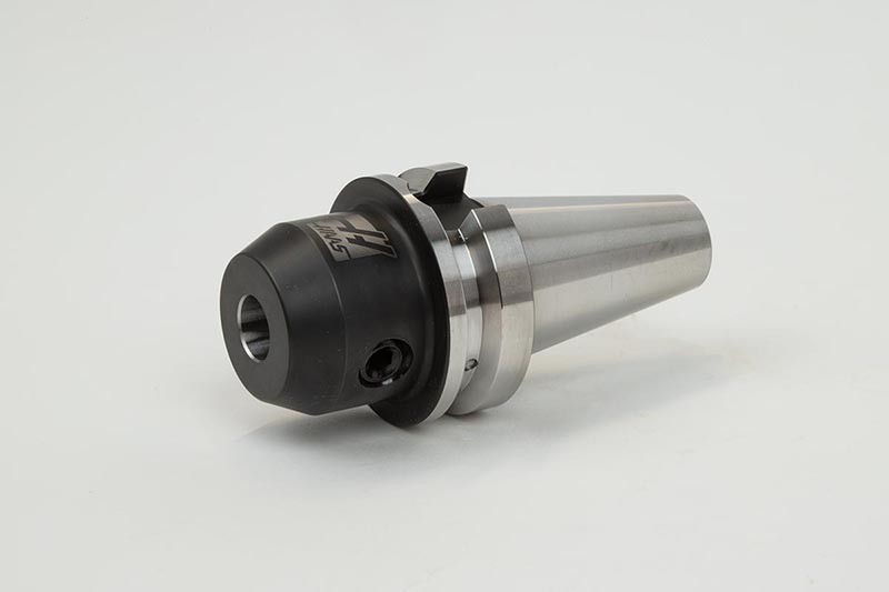

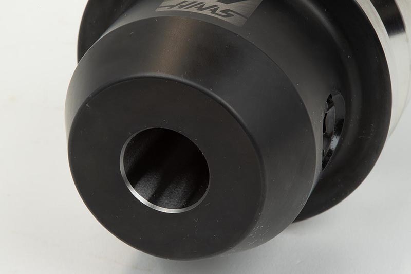

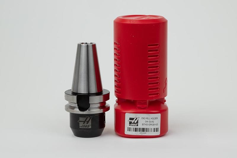

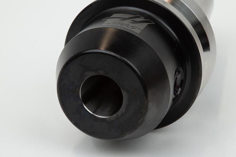

This BT40 end mill holder has a 14mm bore diameter and a 63mm gage length. It uses the Weldon flat standard with side-lock clamping for secure clamping of cutting tools. It is through-tool coolant (TSC) capable, with a M16x2.0 pull stud/retention knob thread.
Taper BT40
[ØD] Bore Diameter 14.0 mm
[ØBD] Body Diameter 44.0 mm
[ØBD2] Minimum Body Diameter 32.0 mm
[GL] Gage Length 63.0 mm
[BL] Body Length 36.0 mm
[TP1_L] Thread Location 22.5 mm
[TP1] Thread M12x1.75
Concentricity 0.005 mm
Balanced to RPM 20000
Bore Tolerance H5
Retention Knob Thread Size M16X2.0
Through Tool Coolant Yes
Spindle Drive Slots Yes
Weight 2.8 lbs \ 1.3 kg
