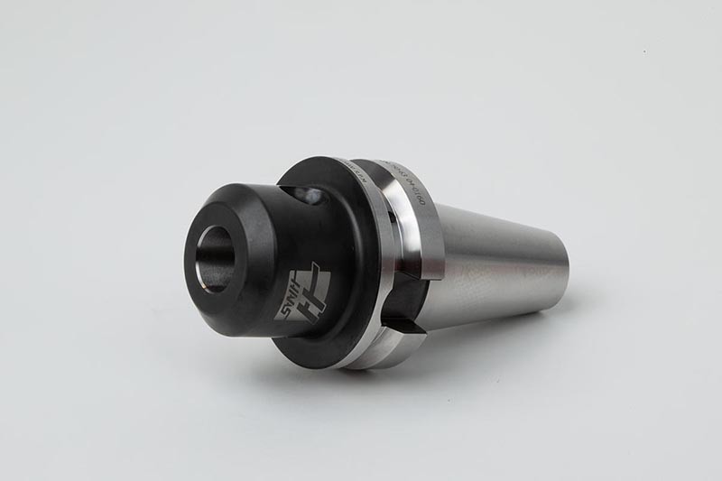

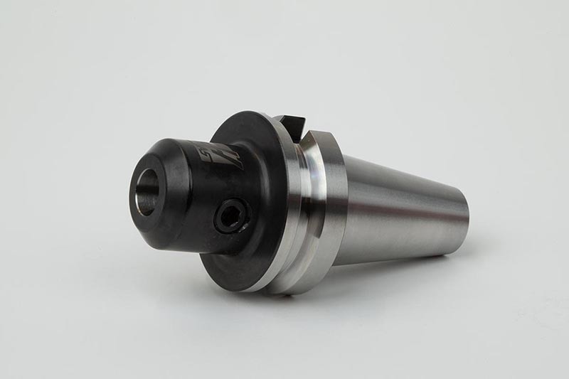

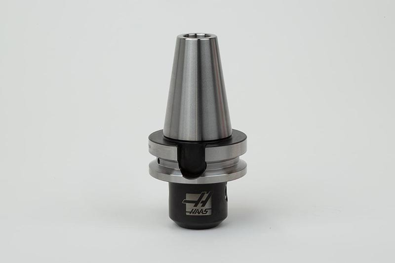

BT40 5/8" End Mill Holder x 63mm Gage Length, TSC
Part #: 04-0159
BT40-EM-0.625-2.48
Price: 69.95 ( / unit)
38.97
This BT40 end mill holder has a 0.625 in \ 5/8" bore diameter and a 63mm gage length. It uses the Weldon flat standard with side-lock clamping for secure clamping of cutting tools. It is through-tool coolant (TSC) capable, with a M16x2.0 pull stud/retention knob thread.

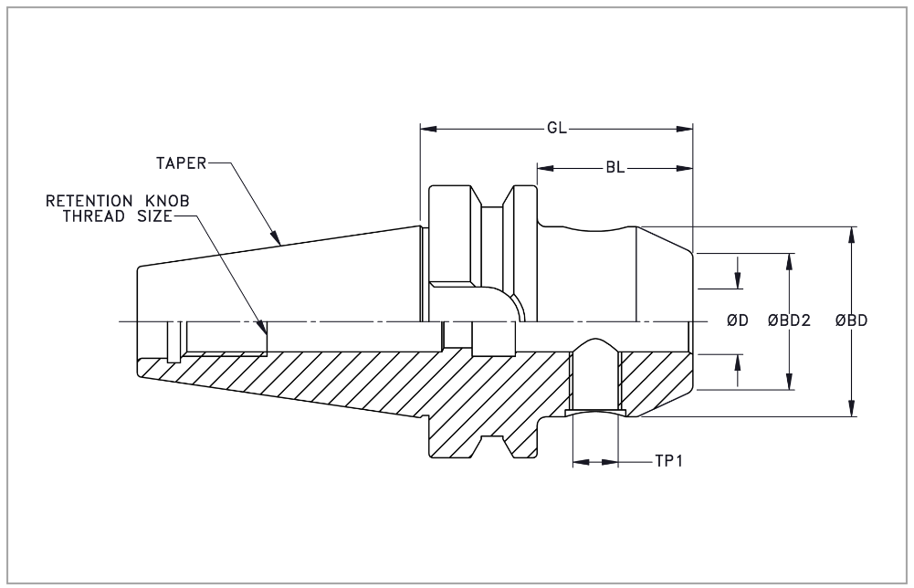

Taper BT40
[ØD] Bore Diameter 0.625 in \ 5/8"
[ØBD] Body Diameter 1.5 in
[ØBD2] Minimum Body Diameter 1.0 in
[GL] Gage Length 2.48 in
[BL] Body Length 1.417 in
[TP1_L] Thread Location 0.938 in
[TP1] Thread 1/2"-20
Concentricity 0.0002 in
Balanced to RPM 20000
Bore Tolerance H5
Retention Knob Thread Size M16X2.0
Through Tool Coolant Yes
Spindle Drive Slots Yes
Weight 2.5 lbs \ 1.2 kg
