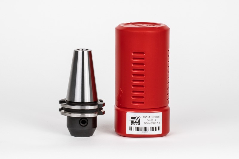

SK40/DIN 12mm End Mill Holder x 50mm Gage Length, TSC
Part #: 04-0519
SK40-EM-12-50
Price: 69.95 ( / unit)
Price: 998.95 ( / unit)
Price: 297.95 ( / unit)
Price: 39.95 ( / unit)
Price: 179.95 ( / unit)
Price: 419.95 ( / unit)
45.97
699.97
208.97
27.97
125.97
293.97

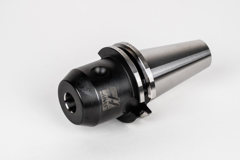

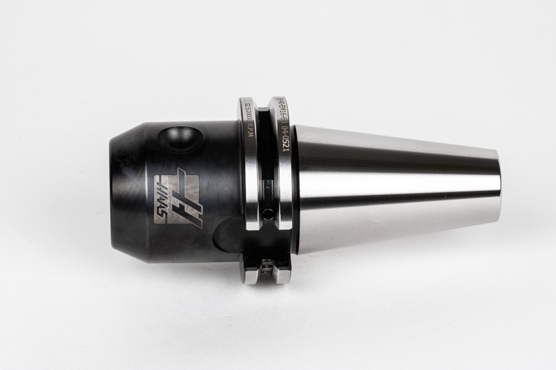

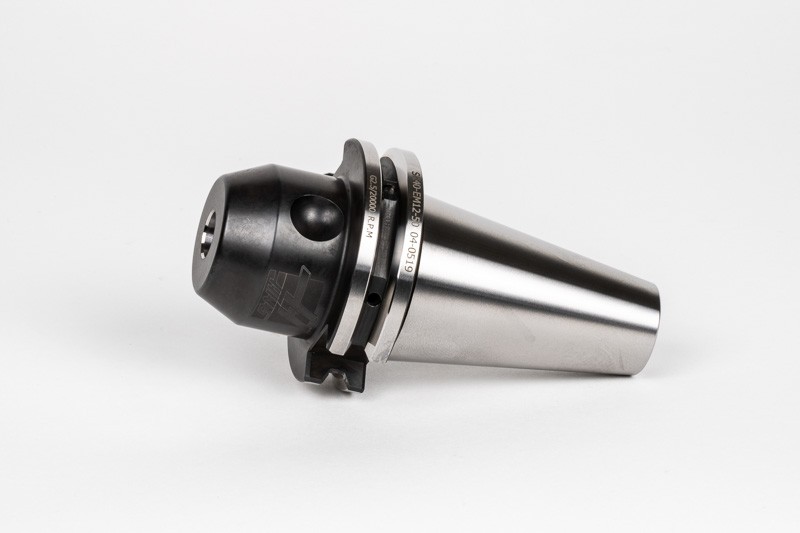

This SK40 \ DIN 69871 end mill holder has a 12mm bore diameter and a 50mm gage length. It uses the Weldon flat standard with side-lock clamping for secure clamping of cutting tools. It is through-tool coolant (TSC) capable, with a M16x2.0 pull stud/retention knob thread.
Taper SK40 \ DIN 69871
[ØD] Bore Diameter 12.0 mm
[ØBD] Body Diameter 42.0 mm
[ØBD2] Minimum Body Diameter 30.0 mm
[GL] Gage Length 50.0 mm
[BL] Body Length 30.9 mm
[TP1_L] Thread Location 22.5 mm
[TP1] Thread M12x1.75
Concentricity 0.005 mm
Balanced to RPM 20000
Bore Tolerance H5
Retention Knob Thread Size M16X2.0
Through Tool Coolant Yes
Spindle Drive Slots Yes
Weight 2.5 lbs \ 1.1 kg
