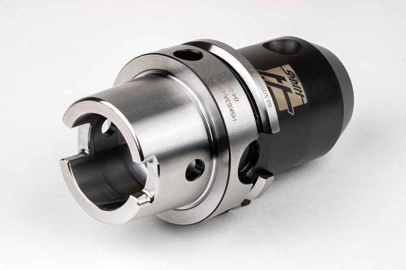

HSK63A 16mm End Mill Holder x 80mm Gage Length, TSC
Part #: 04-0823
HSK63A-EM-16-80
Price: 152.95 ( / unit)
Price: 2248.95 ( / unit)
Price: 669.95 ( / unit)
Price: 89.95 ( / unit)
Price: 404.95 ( / unit)
Price: 944.95 ( / unit)
84.97
1574.97
468.97
62.97
283.97
661.97
This HSK63A end mill holder has a 16mm bore diameter and a 80mm gage length. It uses the Weldon flat standard with side-lock clamping for secure clamping of cutting tools. It is through-tool coolant (TSC) capable.

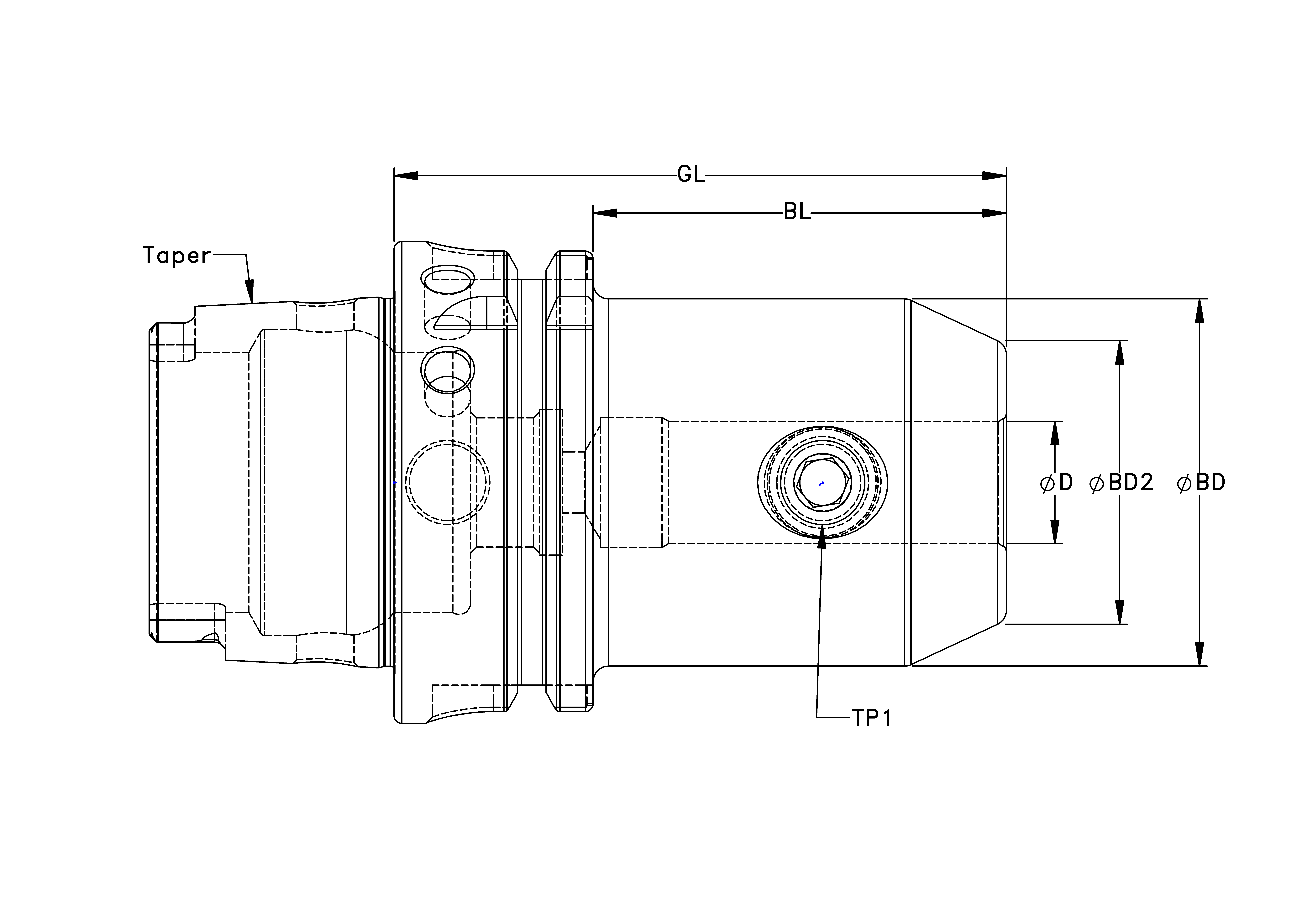

Taper HSK63A
[ØD] Bore Diameter 16.0 mm
[ØBD] Body Diameter 48.0 mm
[ØBD2] Minimum Body Diameter 36.0 mm
[GL] Gage Length 80.0 mm
[BL] Body Length 54.0 mm
[TP1_L] Thread Location 24.0 mm
[TP1] Thread M14x2.0
Concentricity 0.003 mm
Balanced to RPM 25000
Bore Tolerance H5
Through Tool Coolant Yes
Spindle Drive Slots Yes
Weight 3.7 lbs \ 1.7 kg
