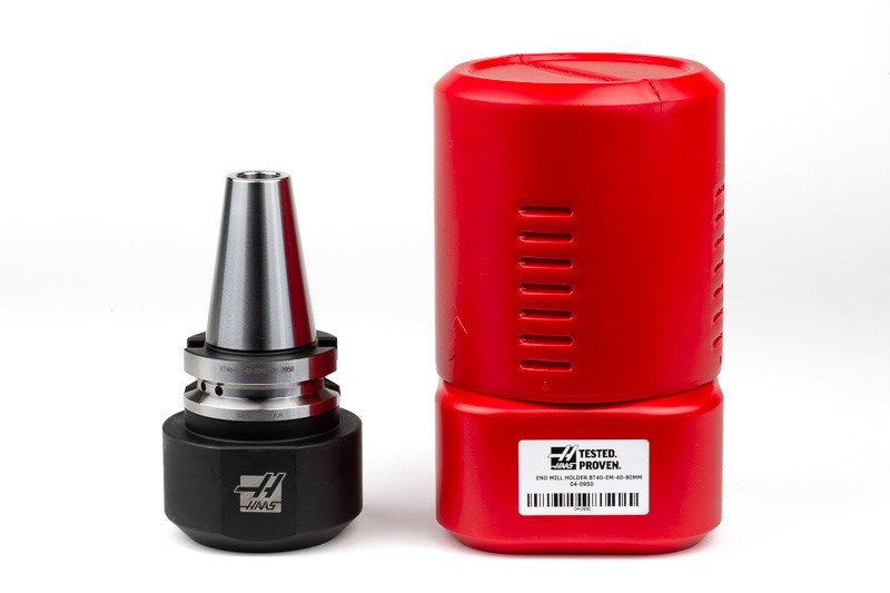

BT40 40mm End Mill Holder x 80mm Gage Length, TSC
Part #: 04-0950
BT40-EM-40-80
Price: 92.95 ( / unit)
Price: 1723.95 ( / unit)
Price: 512.95 ( / unit)
Price: 68.95 ( / unit)
Price: 310.95 ( / unit)
69.97
1224.97
364.97
48.97
220.97

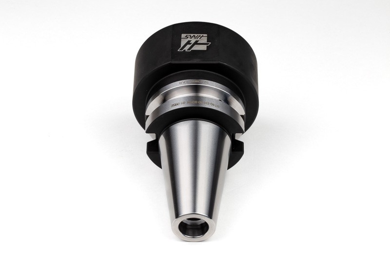

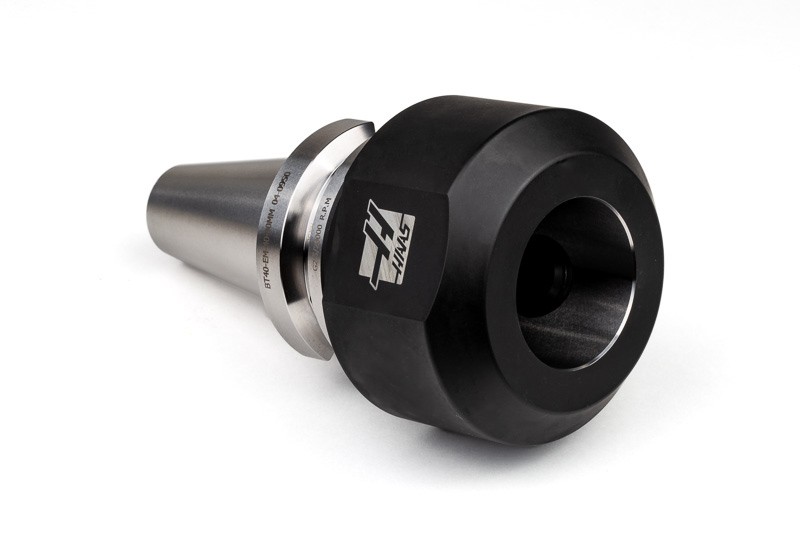

This BT40 end mill holder has a 40mm bore diameter and a 80mm gage length. It uses the Weldon flat standard with side-lock clamping for secure clamping of cutting tools. It is through-tool coolant (TSC) capable, with a M16x2.0 pull stud/retention knob thread.

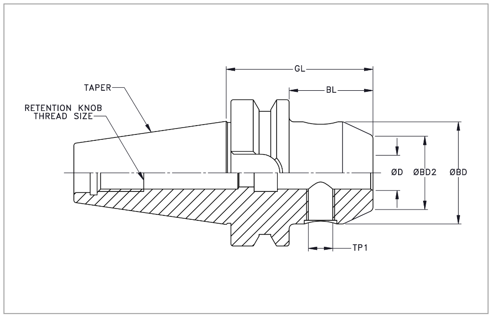

Taper BT40
[ØD] Bore Diameter 40.0 mm
[ØBD] Body Diameter 80.0 mm
[ØBD2] Minimum Body Diameter 60.0 mm
[GL] Gage Length 80.0 mm
[BL] Body Length 53.0 mm
[ØD2] Shoulder Diameter 62.0 mm
[SH] Shoulder Height 8.0 mm
[TP1_L] Thread Location 30.0 mm
[TP1] Thread M20x2.0
Concentricity 0.005 mm
Balanced to RPM 20000
Bore Tolerance H5
Retention Knob Thread Size M16X2.0
Through Tool Coolant Yes
Spindle Drive Slots Yes
Weight 7.16 lb \ 3.25 kg
