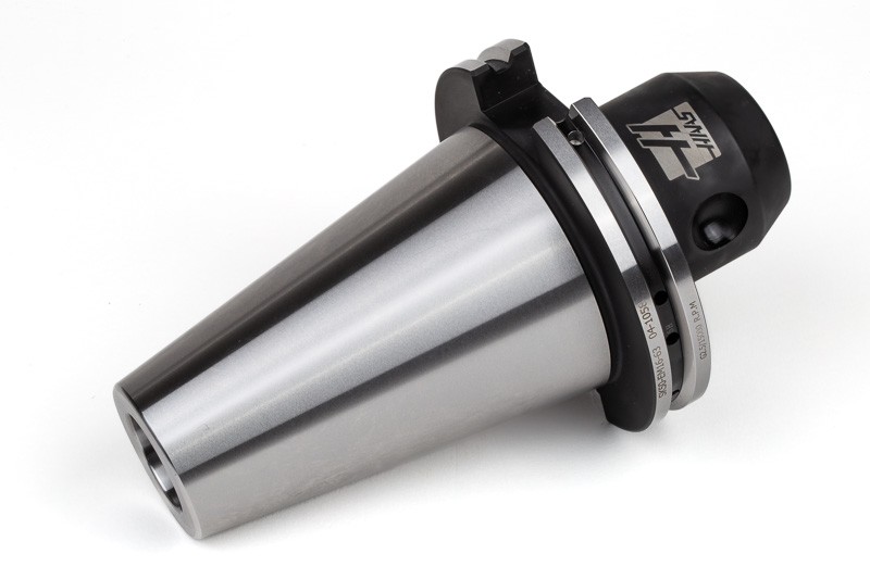

This SK50 \ DIN 69871 end mill holder has a 16mm bore diameter and a 63mm gage length. It uses the Weldon flat standard with side-lock clamping for secure clamping of cutting tools. It is through-tool coolant (TSC) capable, with a M24x3.0 pull stud/retention knob thread.
Taper SK50 \ DIN 69871
[ØD] Bore Diameter 16.0 mm
[ØBD] Body Diameter 48.0 mm
[ØBD2] Minimum Body Diameter 36.0 mm
[GL] Gage Length 63.0 mm
[BL] Body Length 43.9 mm
[TP1_L] Thread Location 24.0 mm
[TP1] Thread M14x2.0
Concentricity 0.005 mm
Balanced to RPM 15000
Bore Tolerance H5
Retention Knob Thread Size M24X3.0
Through Tool Coolant Yes
Spindle Drive Slots Yes
Weight 7.1 lbs \ 3.2 kg
