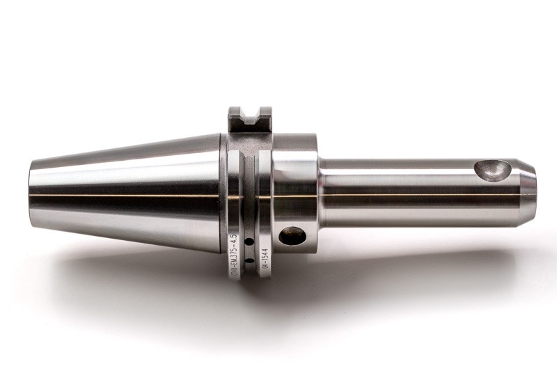

CT40 3/8" End Mill Holder x 2-1/2" Gage Length, TSC
Part #: 04-1541
CT40-EM.375-2.5
Price: 121.95 ( / unit)
This CAT40 end mill holder has a 0.375 in \ 3/8" bore diameter and a 2-1/2" gage length. It uses the Weldon flat standard with side-lock clamping for secure clamping of cutting tools. It is through-tool coolant (TSC) capable, with a 5/8"-11 pull stud/retention knob thread.
Taper CT40
[ØD] Bore Diameter 0.375 in \ 3/8"
[ØBD] Body Diameter 1.75 in
[ØBD2] Minimum Body Diameter 1.0 in
[GL] Gage Length 2.5 in
[BL] Body Length 1.75 in
[TP1] Thread 3/8"-24
Concentricity 0.0002 in
Balanced to RPM 25000
Bore Tolerance H5
Retention Knob Thread Size 5/8"-11
Through Tool Coolant Yes
Spindle Drive Slots Yes
Weight 2.5 lbs \ 1.1 kg
