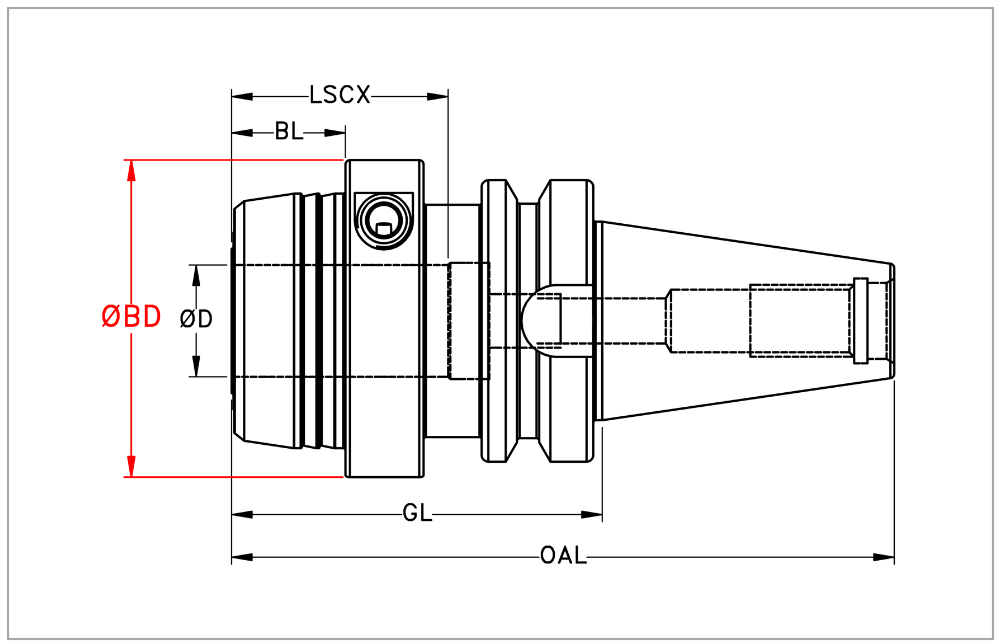

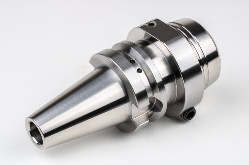

This BT40 hydraulic milling chuck has a 25mm bore diameter and a 83mm gage length. The chuck accepts precision straight-shank collets (optional) to reduce the bore and hold smaller diameter tools. The hydraulic fluid within the chuck compresses to provide equal pressure around the cutting tool shank, providing high grip strength, low runout, and excellent damping properties. It is through-tool coolant (TSC) capable, with a M16x2.0 pull stud/retention knob thread.
  • Technical Documents
NOTE: Hydraulic holders that exceed 2.5" (63mm) [ØBD] Body Diameter need to be defined as a "Large Tool" in the Haas Control depending on your tool changer.
Item Hydraulic Chuck
Taper BT40
[ØD] Bore Diameter 25.0 mm
[ØBD] Body Diameter 72.0 mm
[GL] Gage Length 83.0 mm
[BL] Body Length 25.5 mm
[LSCX] Maximum Clamping Length 48.5 mm
[OAL] Overall Length 148.4 mm
Concentricity 0.003 mm
Balanced to RPM 25000
Retention Knob Thread Size M16-2.0
Through Tool Coolant Yes
Screw TS6
Spindle Drive Slots Yes
Weight 4.3 lbs \ 2.0 kg
