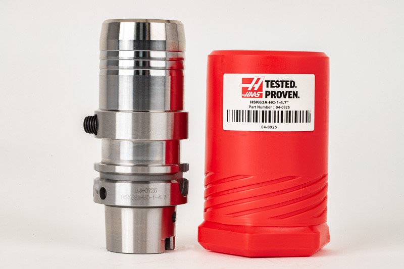

HSK63A 1" Hydraulic Chuck x 4.72" Gage Length TSC
Part #: 04-0925
HSK63A-HC-1-4.7"
Price: 440.95 ( / unit)
308.97
This HSK63A hydraulic milling chuck has a 1.0 in \ 1" bore diameter and a 4.724" gage length. The chuck accepts precision straight-shank collets (optional) to reduce the bore and hold smaller diameter tools. The hydraulic fluid within the chuck compresses to provide equal pressure around the cutting tool shank, providing high grip strength, low runout, and excellent damping properties. It is through-tool coolant (TSC) capable.
  • Technical Documents
NOTE: Hydraulic holders that exceed 2.5" (63mm) [ØBD] Body Diameter need to be defined as a "Large Tool" in the Haas Control depending on your tool changer.
Item Hydraulic Chuck
Taper HSK63A
[ØD] Bore Diameter 1.0 in \ 1"
[ØBD] Body Diameter 2.48 in
[GL] Gage Length 4.724 in
[BL] Body Length 2.323 in
[LSCX] Maximum Clamping Length 1.909 in
[OAL] Overall Length 5.984 in
Concentricity 0.00012”
Balanced to RPM 25000
Through Tool Coolant Yes
Screw TS6
Spindle Drive Slots Yes
Weight 5.0 lbs \ 2.3 kg
