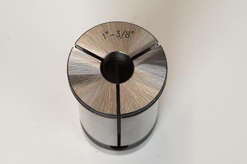

This CAT40 milling chuck has a 1.0 in \ 1" bore diameter and a 4.134" gage length. The chuck accepts precision straight-shank collets (optional) to reduce the bore and hold smaller diameter tools. The simple twist-lock operation provides high grip strength, low runout, and good balance. It is through-tool coolant (TSC) capable, with a 5/8"-11 pull stud/retention knob thread.
