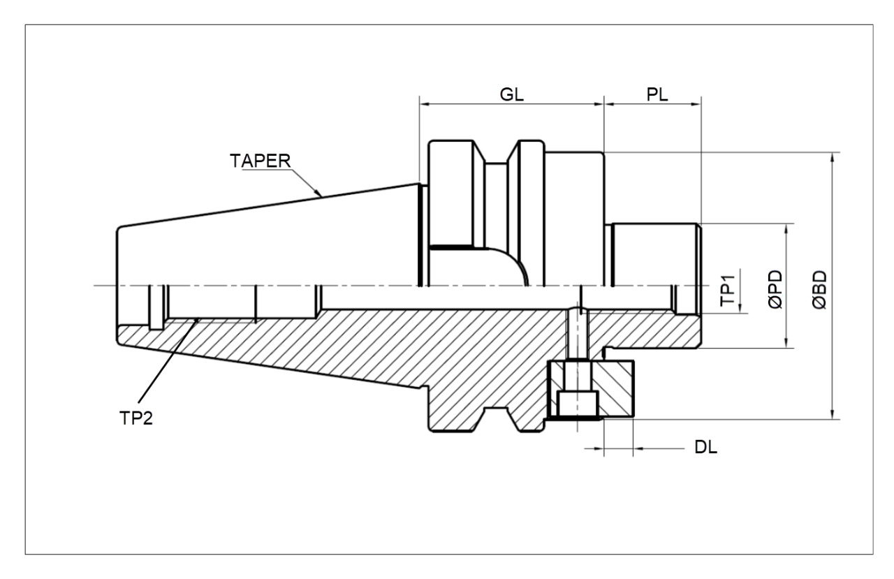

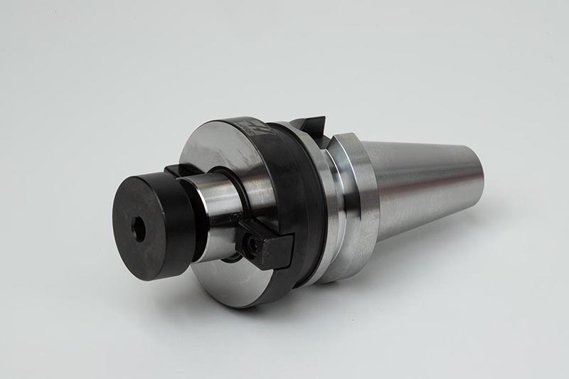

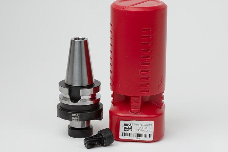

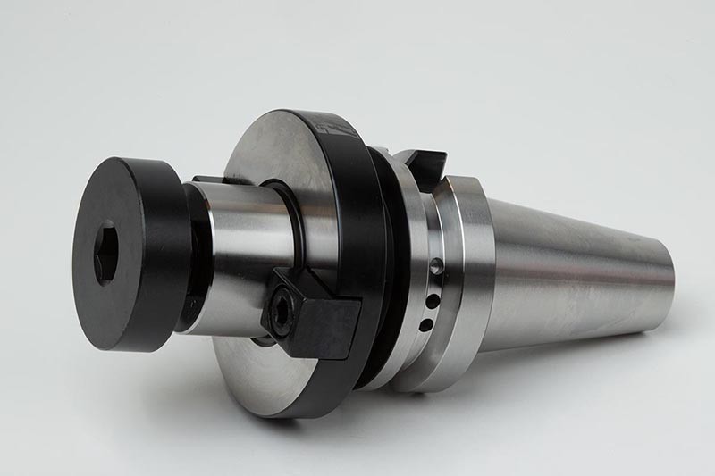

BT40 Shell Mill Holder, 1-1/4" Pilot Diameter x 50mm Gage Length, TSC
Part #: 04-0165
BT40-SM1.25-50
Price: 69.95 ( / unit)
52.97
This BT40 shell mill holder has a 1.25 in \ 1-1/4" pilot bore and a 50mm gage length. It is constructed of hardened alloy steel, and designed to hold a variety of arbor-style shell mill and face mill cutters. The drive keys are removable for added versatility. Includes a solid arbor screw; a coolant-through arbor screw is required for through-tool coolant (TSC) cutters. This holder has a M16x2.0 pull stud/retention knob thread.
Taper BT40
[ØPD] Pilot Diameter 1.25 in \ 1-1/4"
[ØBD] Body Diameter 2.75 in
[GL] Gage Length 1.969 in
[BL] Body Length 0.51 in
[PL] Pilot Length 0.687 in
[DH] Drive Lug Height 0.25 in
[a] Keyway Width 0.5 in
[TP1] Thread 5/8"-18
Concentricity 0.0004 in
Balanced to RPM 20000
Retention Knob Thread Size M16X2.0
Through Tool Coolant Yes
Spindle Drive Slots Yes
Weight 3.7 lbs \ 1.7 kg
