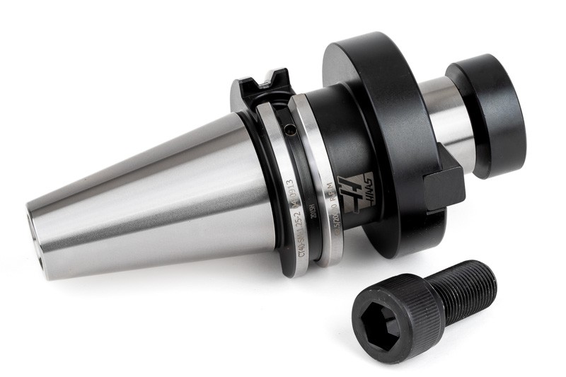

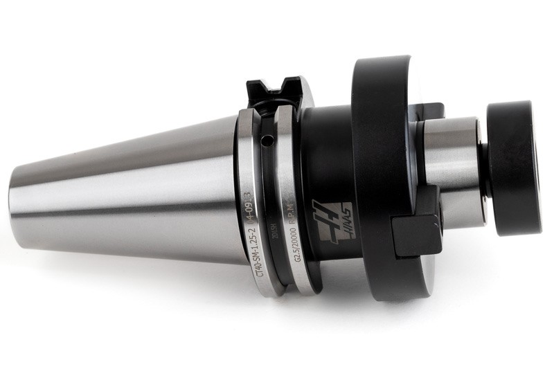

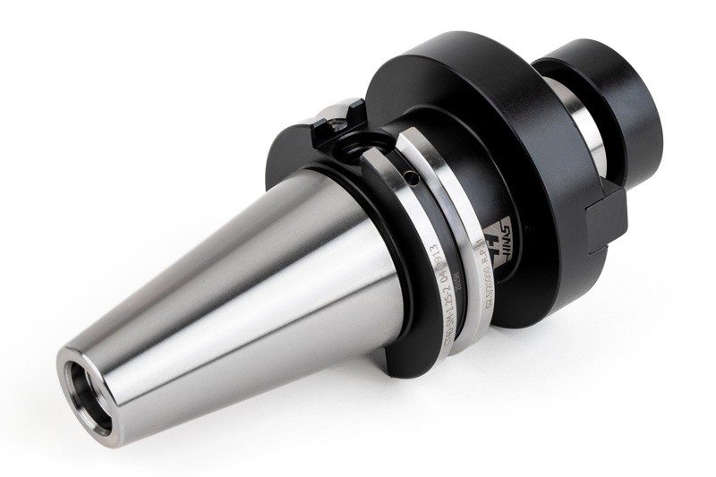

CT40 Shell Mill Holder, 1-1/4" Pilot Diameter x 2" Gage Length, TSC
Part #: 04-0913
CT40-SM-1.25-2"
Price: 80.95 ( / unit)
This CAT40 shell mill holder has a 1.25 in \ 1-1/4" pilot bore and a 2" gage length. It is constructed of hardened alloy steel, and designed to hold a variety of arbor-style shell mill and face mill cutters. The drive keys are removable for added versatility. Includes a solid arbor screw; a coolant-through arbor screw is required for through-tool coolant (TSC) cutters. This holder has a 5/8"-11 pull stud/retention knob thread.
Taper CT40
[ØPD] Pilot Diameter 1.25 in \ 1-1/4"
[ØBD] Body Diameter 2.75 in
[GL] Gage Length 2.0 in
[BL] Body Length 0.62 in
[PL] Pilot Length 0.687 in
[DH] Drive Lug Height 0.25 in
[a] Keyway Width 0.5 in
[TP1] Thread 5/8"-18
Concentricity 0.0004 in
Balanced to RPM 20000
Retention Knob Thread Size 5/8"-11
Through Tool Coolant Yes
Spindle Drive Slots Yes
Weight 3.9 lbs \ 1.8 kg
