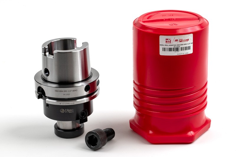

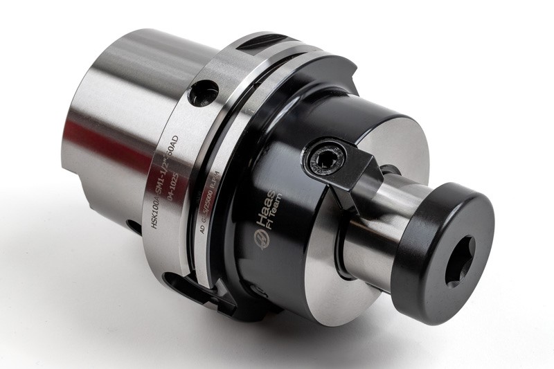

HSK100A Shell Mill Holder, 1-1/2" Pilot Diameter x 2.36" Gage Length, TSC
Part #: 04-1025
HSK100A-SM1-1/2"-60AD
Price: 299.95 ( / unit)
164.97
Taper HSK100A
[ØPD] Pilot Diameter 1.5 in \ 1-1/2"
[ØBD] Body Diameter 3.07 in
[GL] Gage Length 2.362 in
[BL] Body Length 1.22 in
[PL] Pilot Length 0.94 in
[DH] Drive Lug Height 0.31 in
[a] Keyway Width 0.625 in
[TP1] Thread 3/4"-16
Concentricity 0.0002 in
Balanced to RPM 25000
Through Tool Coolant Yes
Spindle Drive Slots Yes
Weight 7.5 lbs \ 3.4 kg
