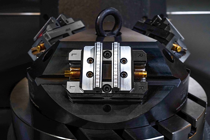

This Haas 3"(75mm) self-centering vise has a maximum opening of 2.5"(64mm), and features a compact, low-profile design that automatically adjusts the workpiece to the center of the vise for increased precision and repeatability. The simple bolt-on jaws are easily changed or reversed, and have built-in serrated gripping surfaces which do NOT feature dovetail jaws. Includes one set of hardened-steel jaws, a ratchet wrench, and all necessary mounting hardware. Replacement hard jaws, as well as machinable steel and aluminum soft jaws, are available.
$877.75 (Save 5%)
Self-Centering Vise
Haas self-centering vises feature a compact, low-profile design that automatically adjusts the workpiece to the center of the vise for increased precision and repeatability. The simple bolt-on jaws are easily changed or reversed, without disassembling the vise, and feature serrated gripping surfaces. The vise comes with serrated teeth to provide maximum grip on non-hardened materials and are NOT dovetail jaws. Replacement hard jaws, as well as machinable steel and aluminum soft jaws, are available.

Kyle Harder
09/03/2024
Great Vice
Ordered this vise for our Haas 5axis trunnion. So far clamps true and holds solid. Fast shipping as usual from Haas.
Taylor Jenkins
05/02/2024
solid vise
i bought this vise for a brother with a 5axis trunnion because i could not find a vise with good clearance on the vise jaw. This one had it and everything is running great making it easy to run shorter tools. jaws are hard enough to put mild divots in 4140 prehard so no need to prep as well
Patrick Bernasconi
Feb 25 2023
We are looking for an adpter plate to mount this self-centering vise on a TRT100. Is there a raiser or adapter plate availiable. We only found solutions for 160 or 210 mm plates but nothing for 100 mm.
1 Answers
Haas Tooling
Feb 28 2023
Hi Patrick, Unfortunately we currently do not offer either at this time. Please check back regularly. You can also sign up for emails to get product announcements here: https://www.haascnc.com/about/Newletter_Signup.html Thank you, Haas Tooling
Greg
Dec 20 2022
Hello, what is the repeatability of Haas self centering vises?
1 Answers
Haas Tooling
Dec 20 2022
Hi Greg, This self-centering vise has 0.01 mm or ~0.004" of repeatability. If you have any more questions please feel free to email customer support. Thank you, Haas Tooling
Tony Christianson, PhD
Nov 10 2022
Can the 3" Self-Centering Vise, Part #: 05-0013 be used on the HRT110 rotary? having 360-degree clearance?
1 Answers
Haas Tooling Support
Nov 11 2022
Hello, Theoretically it can. The vise has a 5.705” circle when measured from point to point on the longest ends. The HRT110 has a 3” center height from the base which allow for a 6” diameter clearance. The 0.354” diameter Bolt holes on center are 2.362” apart. The vise would need a custom sub-plate to bolt on to the platter of the HRT110. Thank you, Haas Tooling
