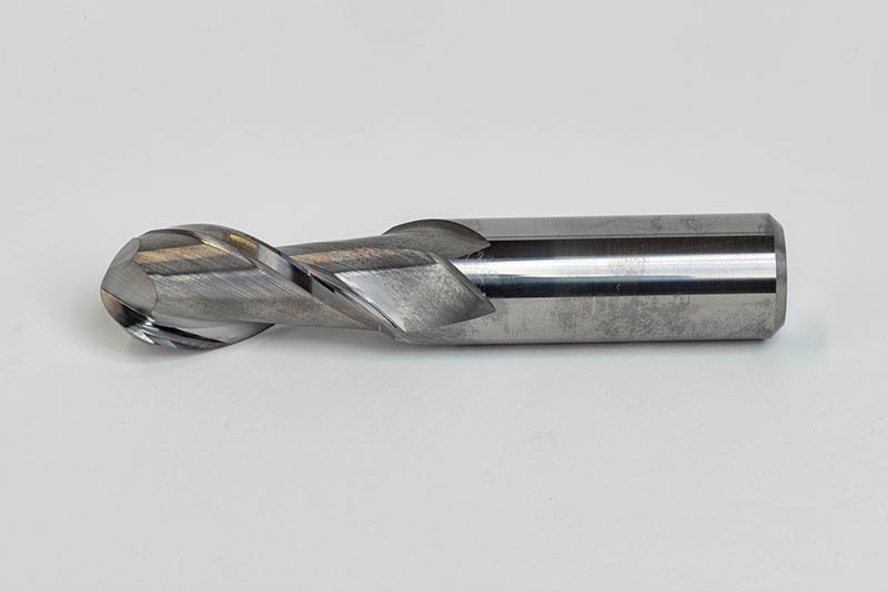

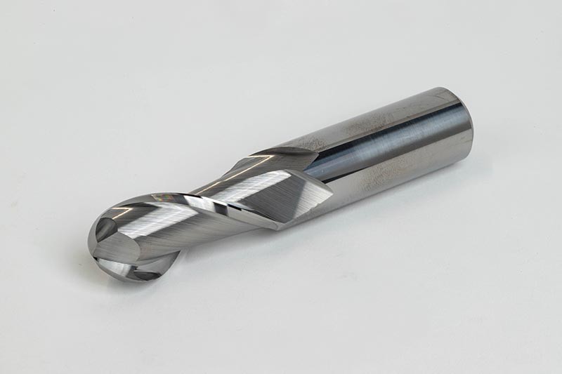

This HSAM1 2-flute carbide ball end mill has a 0.625 in \ 5/8" cutting diameter, with a 5/8" smooth shank, 1-5/8" length of cut (LOC), 5/16" ball radius, and a 3-1/2" overall length. It is uncoated, and made to cut aluminum/non-ferrous materials.
ISO Material Chart
Haas Milling Series HSAM1
Material Carbide
Coating Uncoated
Corner Type Ball
Shank Type Smooth
[ØDC] Cutting Diameter 0.625 in \ 5/8"
[ØDMM] Shank Diameter 0.625 in
[LOC] Length Of Cut 1.625 in
[OAL] Overall Length 3.5 in
[NOF] Number of Flutes 2
[R1] Radius 0.313 in
[FHA°] Helix Angle 37
Cutting Direction Right
Center Cutting Yes
Variable Pitch Yes
Through Spindle Coolant No
Weight 0.5 lbs \ 0.2 kg
