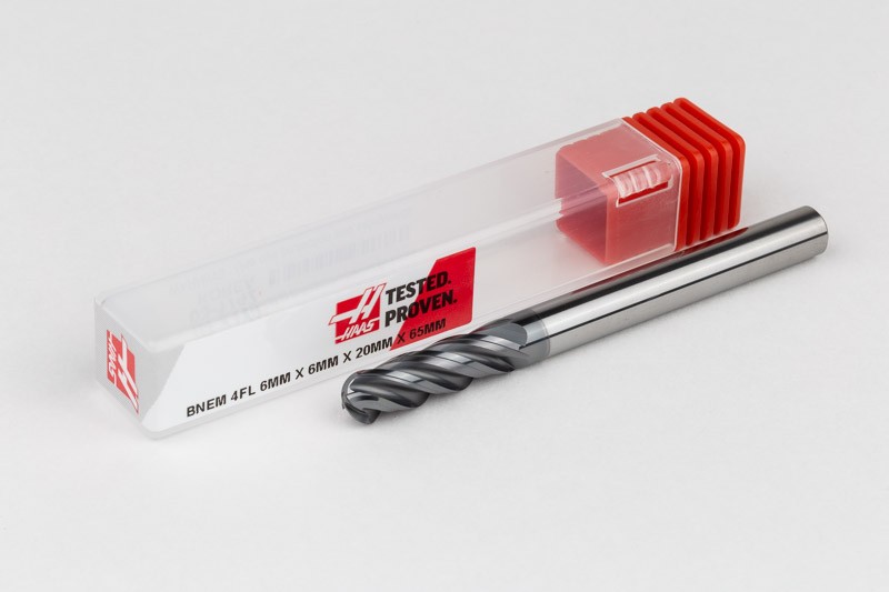

6mm Dia. Carbide Ball End Mill, 4 Flute, Hyb. AlCrN Coated, 6mm Smooth Shank x 20mm LOC, HTPM
Part #: 03-1742
BNEM 4FL 6MM X 6MM X 20MM X 65MM

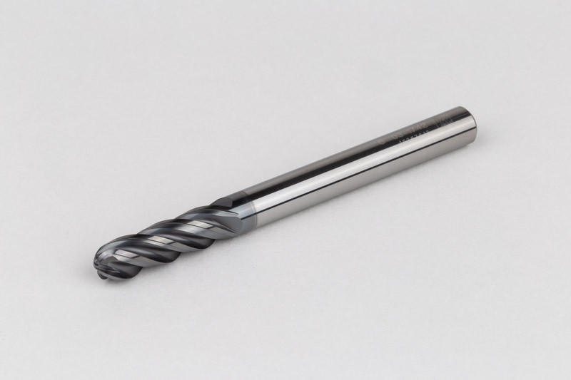

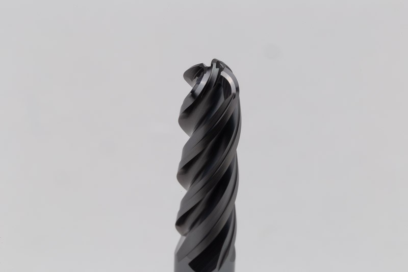

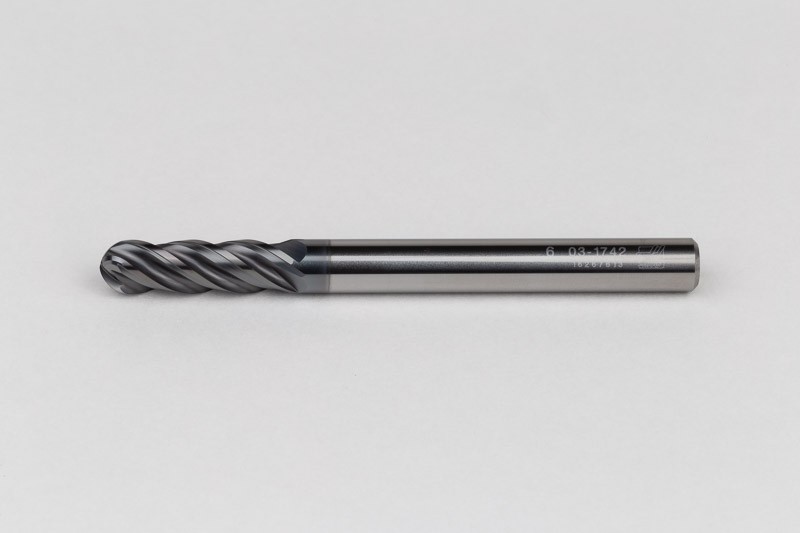

This HTPM 4-flute carbide ball end mill has a 6mm cutting diameter, with a 6mm smooth shank, 20mm length of cut (LOC), 3mm ball radius, and a 65mm overall length. It is hybrid AlCrN coated, and made to cut steel, stainless steel, and cast iron, but is capable of cutting some grades of high temp. alloys.
ISO MATERIAL CHART
Haas Milling Series HTPM
Primary Workpiece Material K - Cast Iron, M - Stainless Steel, P - Steel
Material Carbide
Coating Hybrid AlCrN
Corner Type Ball
Shank Type Smooth
[ØDC] Cutting Diameter 6.0 mm
[ØDMM] Shank Diameter 6.0 mm
[LOC] Length Of Cut 20.0 mm
[OAL] Overall Length 65.0 mm
[NOF] Number of Flutes 4
[R1] Radius 3.0 mm
[FHA°] Helix Angle 35/37
Cutting Direction Right
Center Cutting Yes
Variable Pitch Yes
Through Spindle Coolant No
Weight 0.2 lbs \ 0.1 kg
