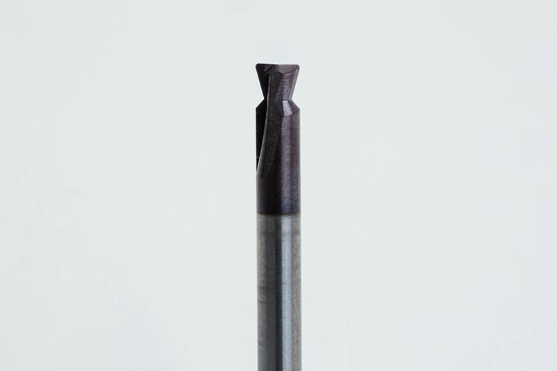

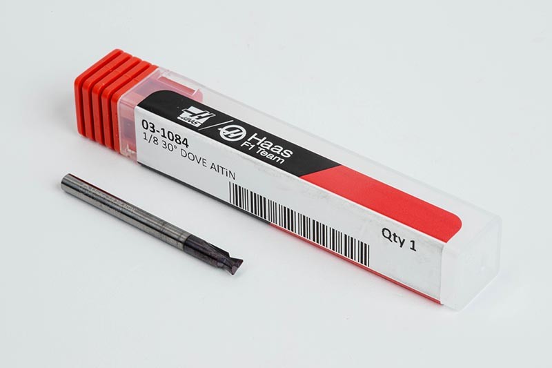

1/8" Dia. Carbide Dovetail Cutter, 2 Flute, AlTiN Coated, 1/8" Shank x 0.093" LOC x 30° Included Angle, 0.01" Radius
Part #: 03-1084
DOVETAIL CUTTER CARBIDE 1/8" 30 DEG
Price: 39.95 ( / unit)
21.97
This 30-degree 2-flute carbide dovetail cutter has a 0.125 in \ 1/8" cutting diameter, with a 1/8" smooth shank, 0.093" length of cut (LOC), 0.01" corner radius, and a 1-1/2" overall length. It is AlTiN coated, and made to cut steel, stainless steel, cast iron, high temp. alloys, and hardened metals.

[ØDC] Cutting Diameter 0.125 in \ 1/8"
[ØDMM] Shank Diameter 0.125 in
[ØN] Neck Diameter 0.08 in
[LOC] Length Of Cut 0.093 in
[OAL] Overall Length 1.5 in
[NOF] Number of Flutes 2
[CHW\RE] Chamfer \ Radius Size 0.01 in
[SIG°] Included Angle 30
Cutting Direction Right
