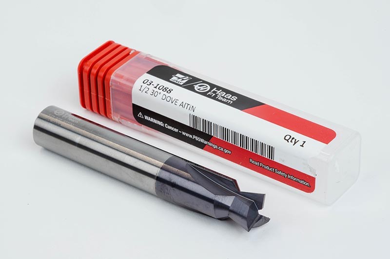

1/2" Dia. Carbide Dovetail Cutter, 3 Flute, AlTiN Coated, 1/2" Shank x 0.312" LOC x 30° Included Angle, 0.01" Radius
Part #: 03-1088
DOVETAIL CUTTER CARBIDE 1/2" 30 DEG
Price: 103.95 ( / unit)
46.97
This 30-degree 3-flute carbide dovetail cutter has a 0.5 in \ 1/2" cutting diameter, with a 1/2" smooth shank, 0.312" length of cut (LOC), 0.01" corner radius, and a 3" overall length. It is AlTiN coated, and made to cut steel, stainless steel, cast iron, high temp. alloys, and hardened metals.

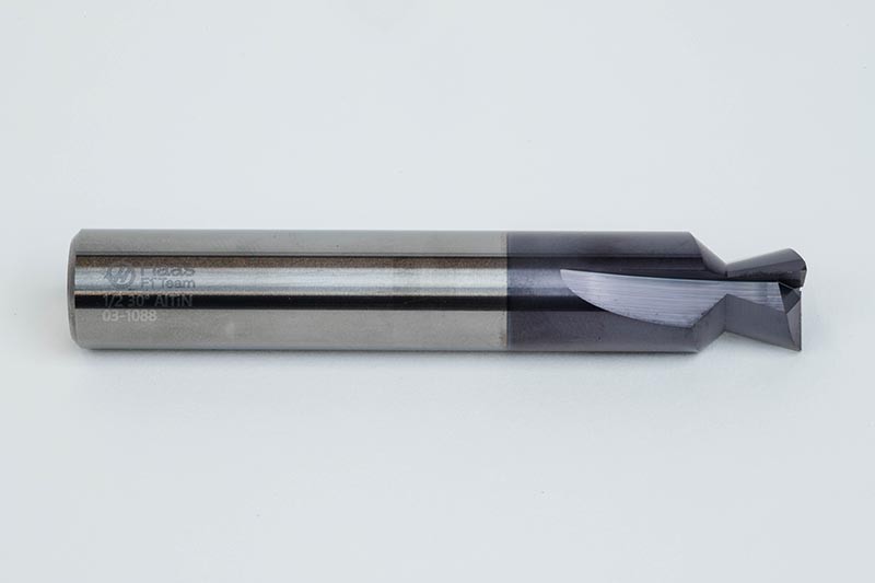

[ØDC] Cutting Diameter 0.5 in \ 1/2"
[ØDMM] Shank Diameter 0.5 in
[ØN] Neck Diameter 0.339 in
[LOC] Length Of Cut 0.312 in
[OAL] Overall Length 3.0 in
[NOF] Number of Flutes 3
[CHW\RE] Chamfer \ Radius Size 0.01 in
[SIG°] Included Angle 30
Cutting Direction Right
