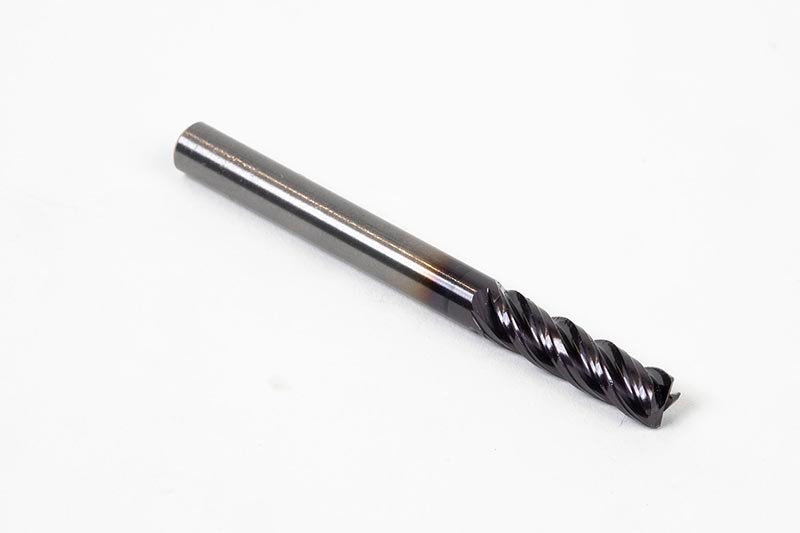

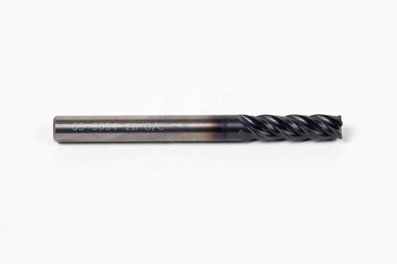

3/16" Dia. Carbide End Mill, 4 Flute, TiAlN Coated, 3/16" Smooth Shank x 5/8" LOC, 0.008" Chamfer, HSPM1
Part #: 03-0054
HP EM 4 FLUTE 3/16" DIAMETER
Price: 16.95 ( / unit)
11.97
This HSPM1 4-flute carbide end mill has a 0.1875 in \ 3/16" cutting diameter, with a 3/16" smooth shank, 5/8" length of cut (LOC), 0.008" chamfer, and a 2" overall length. It is TiAlN coated, and made to cut steel, stainless steel, and high-temp. alloys, but is capable of cutting some grades of cast iron and hardened metals. This end mill is designed to center-cut, and the unique, variable pitch configuration helps to reduce unwanted harmonics and vibrations.

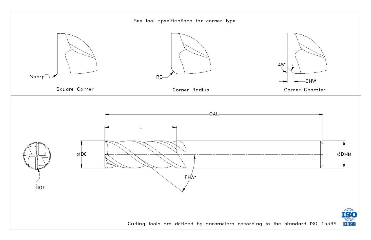

  • Haas Drawing (PDF)
ISO MATERIAL CHART
[ØDC] Cutting Diameter 0.1875 in \ 3/16"
Haas Milling Series HSPM1
Primary Workpiece Material P - Steel, M - Stainless Steel, S - High Temp Alloys
Secondary Workpiece Material K - Cast Iron, H - Hardened Materials
Material Carbide
Coating Multi-Layer TiAlN
Corner Type Chamfer
Shank Type Smooth
[ØDMM] Shank Diameter 0.1875 in
[LOC] Length Of Cut 0.625 in
[OAL] Overall Length 2.0 in
[NOF] Number of Flutes 4
[CHW\RE] Chamfer \ Radius Size 0.008 in
[FHA°] Helix Angle 38
Cutting Direction Right
Center Cutting Yes
Variable Pitch Yes
Through Spindle Coolant No
Country of Origin Various
