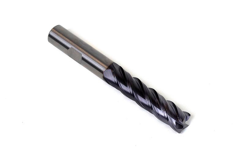

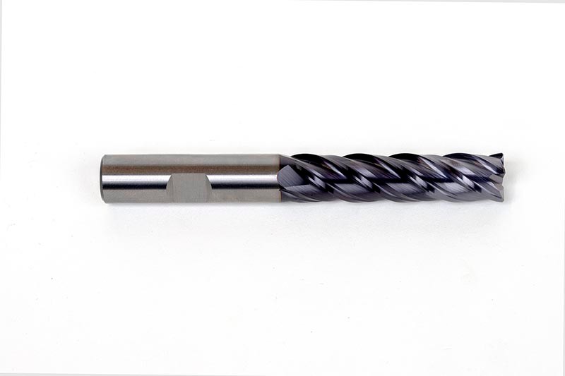

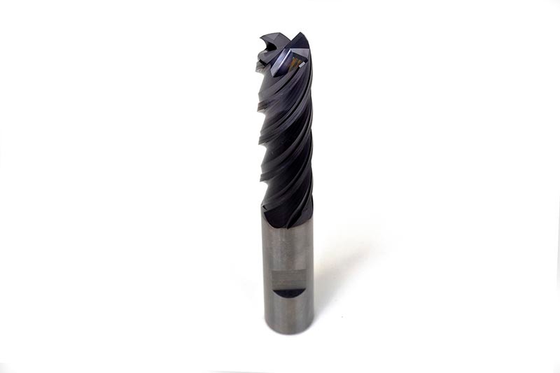

This HSPM1 4-flute carbide end mill has a 0.5 in \ 1/2" cutting diameter, with a 1/2" weldon shank, 2" length of cut (LOC), 0.02" ch amfer, and a 4" overall length. It is TiAlN coated, and made to cut steel, stainless steel, and high-temp. alloys, but is capable of cutting some grades of cast iron and hardened metals. This end mill is designed to center-cut, and the unique, variable pitch configuration helps to reduce unwanted harmonics and vibrations.

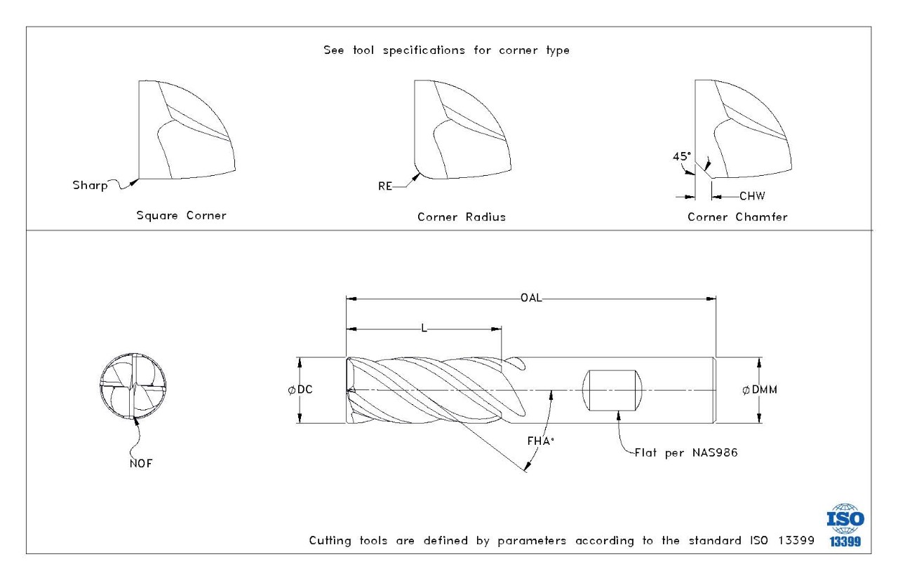

[ØDC] Cutting Diameter 0.5 in \ 1/2"
Haas Milling Series HSPM1
Primary Workpiece Material S - High Temp Alloys, M - Stainless Steel, P - Steel
Secondary Workpiece Material H - Hardened Materials, K - Cast Iron
Material Carbide
Coating Multi-Layer TiAlN
Corner Type Chamfer
Shank Type Weldon
[ØDMM] Shank Diameter 0.5 in
[LOC] Length Of Cut 2.0 in
[OAL] Overall Length 4.0 in
[NOF] Number of Flutes 4
[CHW\RE] Chamfer \ Radius Size 0.02 in
[FHA°] Helix Angle 38
Cutting Direction Right
Center Cutting Yes
Variable Pitch Yes
