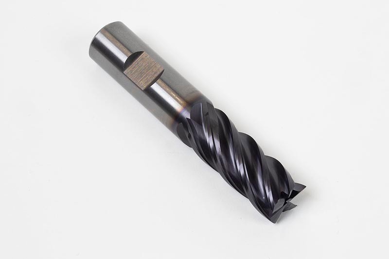

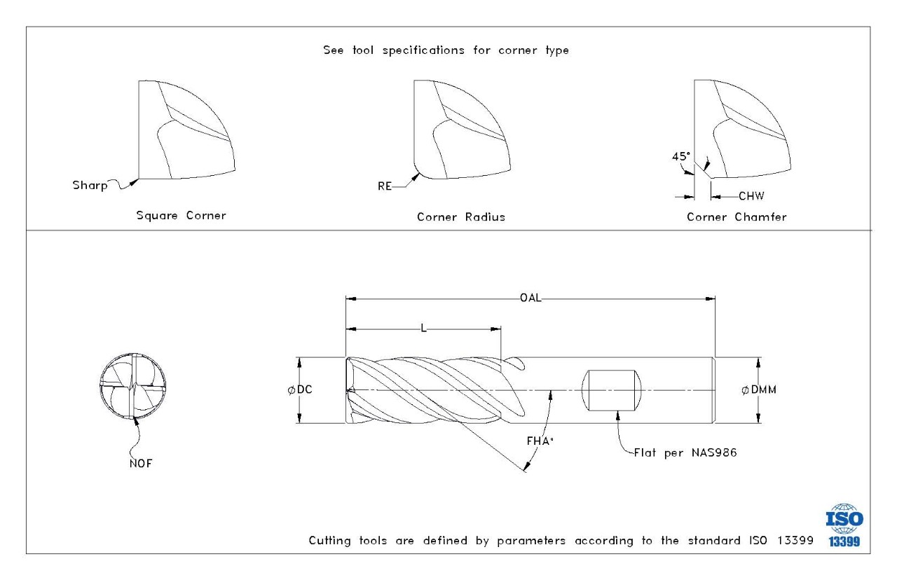

This HSPM2 5-flute carbide end mill has a 0.75 in \ 3/4" cutting diameter, with a 3/4" weldon shank, 1-5/8" length of cut (LOC), square profile, and a 4" overall length. It is TiAlN coated, and made to cut steel, stainless steel, and high-temp. alloys, but is capable of cutting some grades of cast iron and hardened metals. This end mill is designed to center-cut, and the unique, variable pitch configuration helps to reduce unwanted harmonics and vibrations.
  • Haas Drawing (PDF)
ISO MATERIAL CHART
[ØDC] Cutting Diameter 0.75 in \ 3/4"
Haas Milling Series HSPM2
Primary Workpiece Material S - High Temp Alloys, M - Stainless Steel, P - Steel
Secondary Workpiece Material H - Hardened Materials, K - Cast Iron
Material Carbide
Coating Multi-Layer TiAlN
Corner Type Square
Shank Type Weldon
[ØDMM] Shank Diameter 0.75 in
[LOC] Length Of Cut 1.625 in
[OAL] Overall Length 4.0 in
[NOF] Number of Flutes 5
[FHA°] Helix Angle 38
Cutting Direction Right
Center Cutting Yes
Variable Pitch Yes
Through Spindle Coolant No
Weight 0.8 lbs \ 0.4 kg
Country of Origin Various
