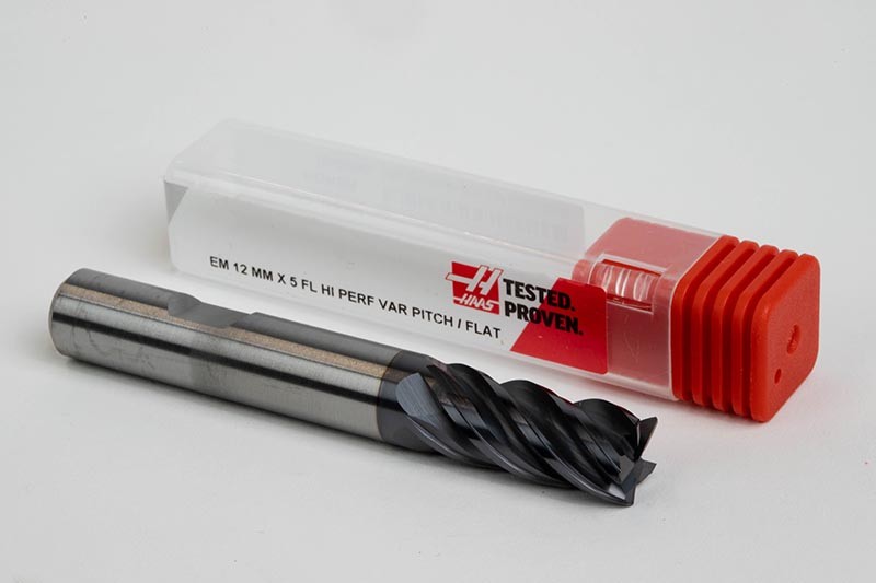

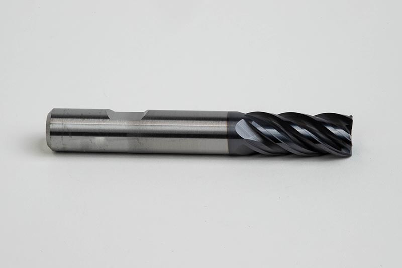

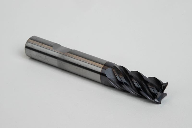

This HTM 5-flute carbide end mill has a 12mm cutting diameter, with a 12mm weldon shank, 26mm length of cut (LOC), 0.35mm chamfer, and a 83mm overall length. It is AlTiN coated, and made to cut stainless steel and high-temp. alloys, but is capable of cutting some grades of steel and cast iron. This end mill is designed to center-cut, and the unique, variable pitch configuration helps to reduce unwanted harmonics and vibrations.
ISO Material Chart
[ØDC] Cutting Diameter 12.0 mm
Haas Milling Series HTM
Primary Workpiece Material M - Stainless Steel, S - High Temp Alloys
Secondary Workpiece Material K - Cast Iron, P - Steel
Material Carbide
Coating AlTiN
Corner Type Chamfer
Shank Type Weldon
[ØDMM] Shank Diameter 12.0 mm
[LOC] Length Of Cut 26.0 mm
[OAL] Overall Length 83.0 mm
[NOF] Number of Flutes 5
[CHW\RE] Chamfer \ Radius Size 0.35 mm
[FHA°] Helix Angle 38
Cutting Direction Right
Center Cutting Yes
Variable Pitch Yes
Through Spindle Coolant No
Weight 0.3 lbs \ 0.2 kg
