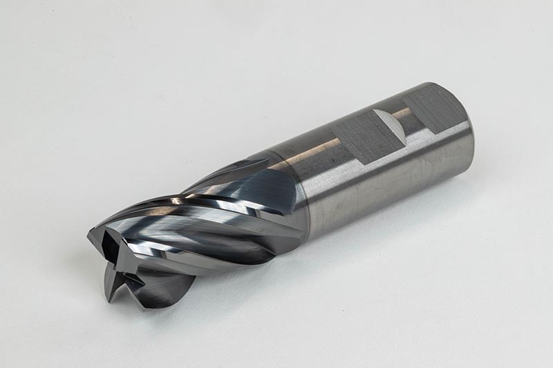

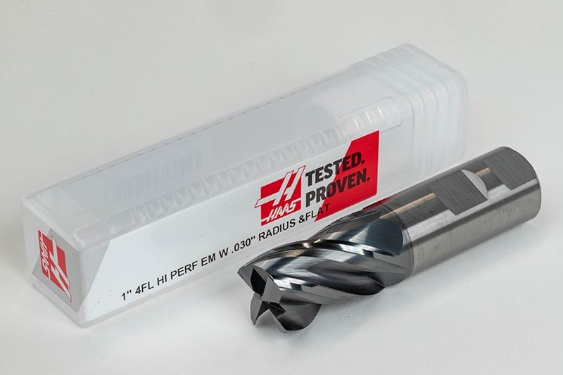

1" Dia. Carbide End Mill, 4 Flute, Hyb. AlCrN Coated, 1" Weldon Shank x 1-1/2" LOC, 0.03" Radius, HTPM
Part #: 03-0561
1" 4FL HI PERF EM W .030" RADIUS & FLAT
Price: 173.95 ( / unit)
This HTPM 4-flute carbide end mill has a 1.0 in \ 1" cutting diameter, with a 1" weldon shank, 1-1/2" length of cut (LOC), 0.03" radius, and a 4" overall length. It is hybrid AlCrN coated, and made to cut steel, stainless steel, and cast iron, but is capable of cutting some grades of high-temp. alloys. This end mill is designed to center-cut, and the unique, variable pitch configuration helps to reduce unwanted harmonics and vibrations.
ISO Material Chart
[ØDC] Cutting Diameter 1.0 in \ 1"
Haas Milling Series HTPM
Primary Workpiece Material K - Cast Iron, M - Stainless Steel, P - Steel
Material Carbide
Coating Hybrid AlCrN
Corner Type Radius
Shank Type Weldon
[ØDMM] Shank Diameter 1.0 in
[LOC] Length Of Cut 1.5 in
[OAL] Overall Length 4.0 in
[NOF] Number of Flutes 4
[CHW\RE] Chamfer \ Radius Size 0.03 in
[FHA°] Helix Angle 35/37
Cutting Direction Right
Center Cutting Yes
Variable Pitch Yes
Through Spindle Coolant No
Weight 1.5 lbs \ 0.7 kg
