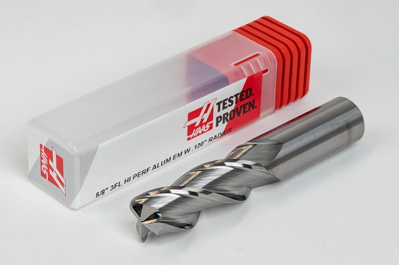

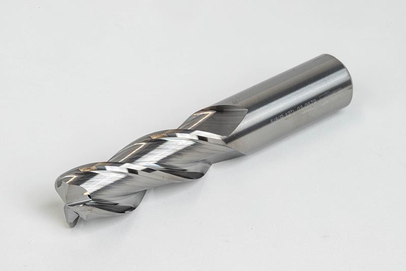

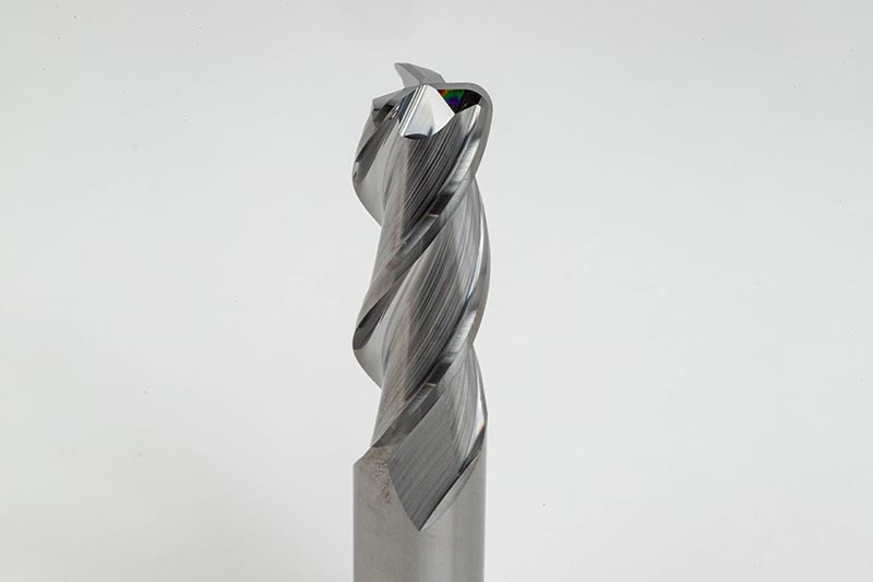

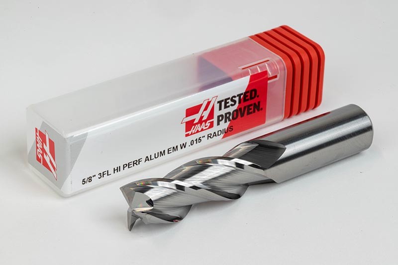

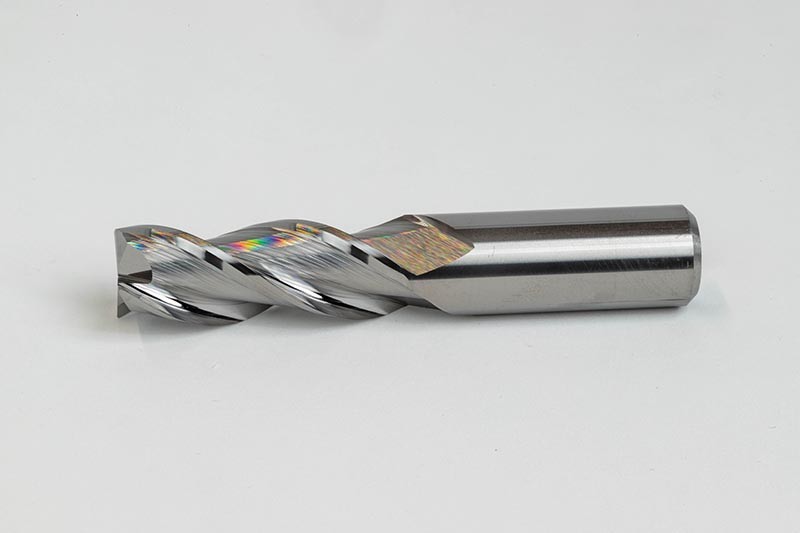

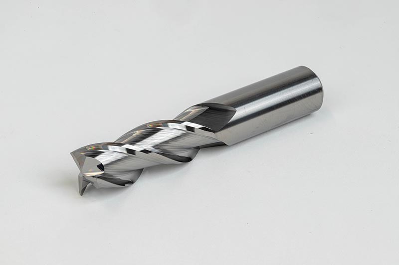

5/8" Dia. Carbide End Mill, 3 Flute, Uncoated, 5/8" Smooth Shank x 1-5/8" LOC, 0.015" Radius, HSAM2
Part #: 03-0576
5/8" 3FL HI PERF ALUM EM W .015" RADIUS
Price: 86.95 ( / unit)
78.97

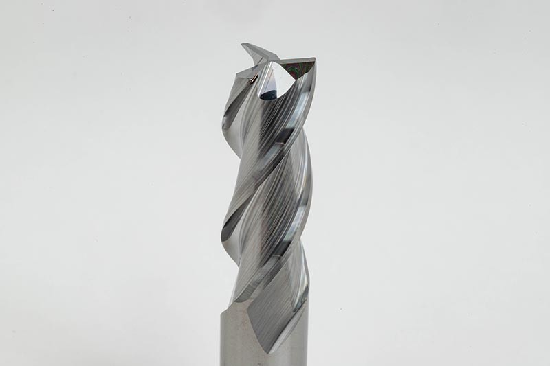

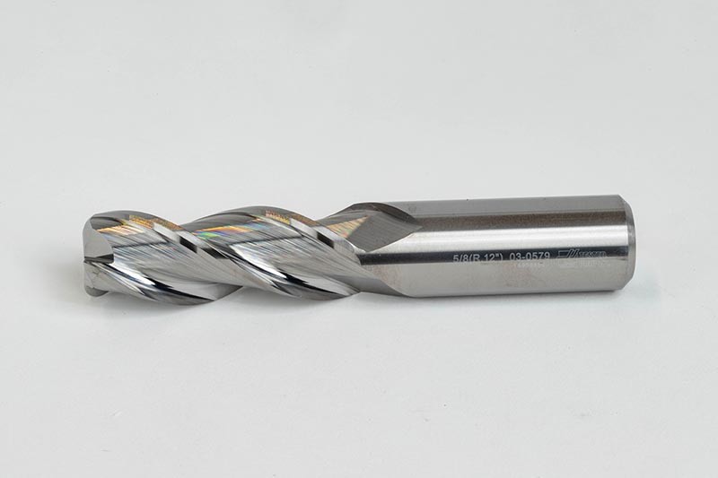

This HSAM2 3-flute carbide end mill has a 0.625 in \ 5/8" cutting diameter, with a 5/8" smooth shank, 1-5/8" length of cut (LOC), 0.015" radius, and a 3-1/2" overall length. It is uncoated, and made to cut aluminum/non-ferrous materials. This end mill is designed to center-cut.
ISO Material Chart
[ØDC] Cutting Diameter 0.625 in \ 5/8"
Haas Milling Series HSAM2
Material Carbide
Coating Uncoated
Corner Type Radius
Shank Type Smooth
[ØDMM] Shank Diameter 0.625 in
[LOC] Length Of Cut 1.625 in
[OAL] Overall Length 3.5 in
[NOF] Number of Flutes 3
[CHW\RE] Chamfer \ Radius Size 0.015 in
[FHA°] Helix Angle 37
Cutting Direction Right
Center Cutting Yes
Variable Pitch No
Through Spindle Coolant No
Weight 0.5 lbs \ 0.3 kg
