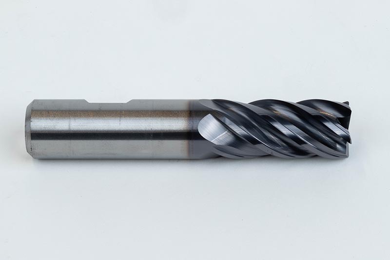

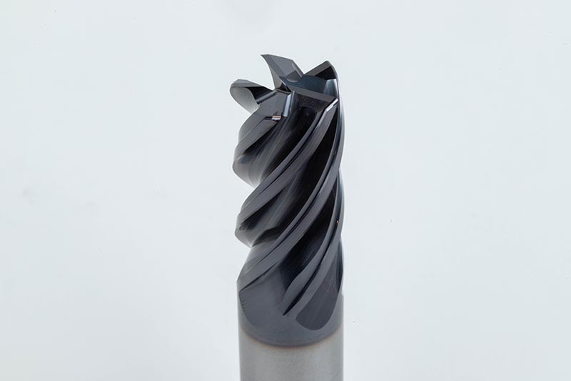

3/4" Dia. Carbide End Mill, 5 Flute, AlTiN Coated, 3/4" Weldon Shank x 1-1/2" LOC, 0.03" Radius, HTM
Part #: 03-0642
3/4" 5 FL HI PERF EM W .030" RADIUS & FL
Price: 110.95 ( / unit)
This HTM 5-flute carbide end mill has a 0.75 in \ 3/4" cutting diameter, with a 3/4" weldon shank, 1-1/2" length of cut (LOC), 0.03" radius, and a 4" overall length. It is AlTiN coated, and made to cut stainless steel and high-temp. alloys, but is capable of cutting some grades of steel and cast iron. This end mill is designed to center-cut, and the unique, variable pitch configuration helps to reduce unwanted harmonics and vibrations.
ISO Material Chart
[ØDC] Cutting Diameter 0.75 in \ 3/4"
Haas Milling Series HTM
Primary Workpiece Material M - Stainless Steel, S - High Temp Alloys
Secondary Workpiece Material K - Cast Iron, P - Steel
Material Carbide
Coating AlTiN
Corner Type Radius
Shank Type Weldon
[ØDMM] Shank Diameter 0.75 in
[LOC] Length Of Cut 1.5 in
[OAL] Overall Length 4.0 in
[NOF] Number of Flutes 5
[CHW\RE] Chamfer \ Radius Size 0.03 in
[FHA°] Helix Angle 38
Cutting Direction Right
Center Cutting Yes
Variable Pitch Yes
Through Spindle Coolant No
Weight 0.9 lbs \ 0.4 kg
