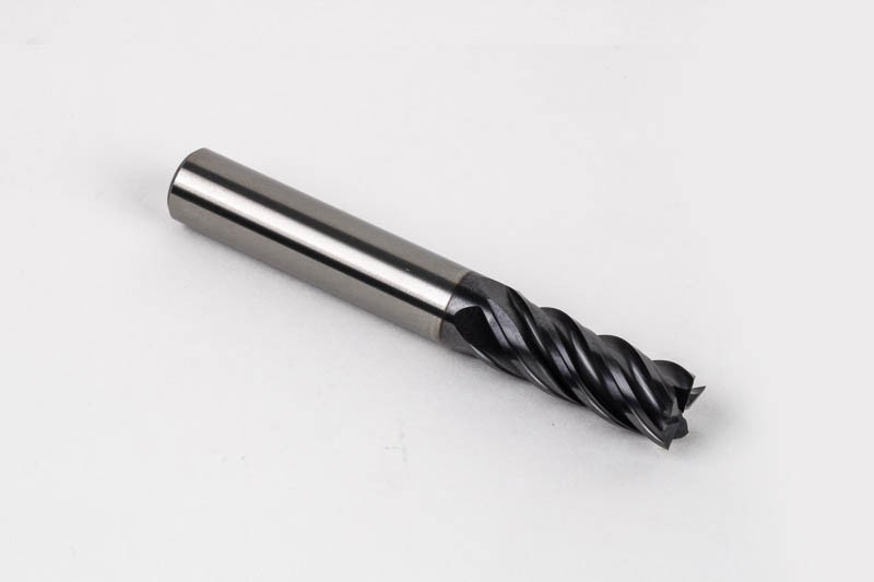

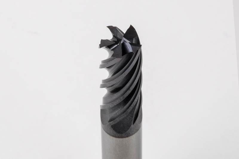

This HTM 5-flute carbide end mill has a 10mm cutting diameter, with a 10mm smooth shank, 25mm length of cut (LOC), square profile, and a 72mm overall length. It is AlTiN coated, and made to cut stainless steel and high-temp. alloys, but is capable of cutting some grades of steel and cast iron. This end mill is designed to center-cut, and the unique, variable pitch configuration helps to reduce unwanted harmonics and vibrations.

[ØDC] Cutting Diameter 10.0 mm
Haas Milling Series HTM
Primary Workpiece Material M - Stainless Steel, S - High Temp Alloys
Secondary Workpiece Material K - Cast Iron, P - Steel
Material Carbide
Coating AlTiN
Corner Type Square
Shank Type Smooth
[ØDMM] Shank Diameter 10.0 mm
[LOC] Length Of Cut 25.0 mm
[OAL] Overall Length 72.0 mm
[NOF] Number of Flutes 5
[FHA°] Helix Angle 38
Cutting Direction Right
Center Cutting Yes
Variable Pitch Yes
Through Spindle Coolant No
Weight 0.2 lbs \ 0.1 kg
