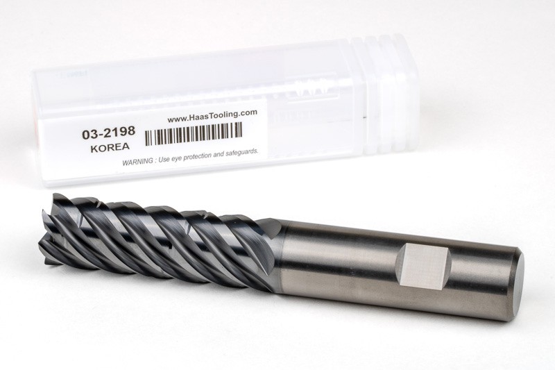

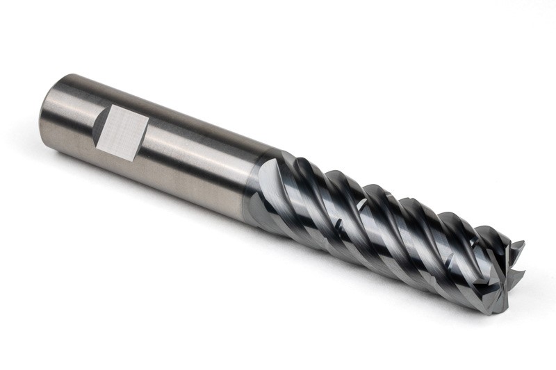

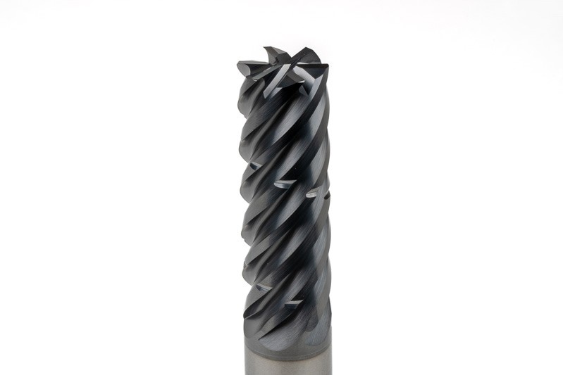

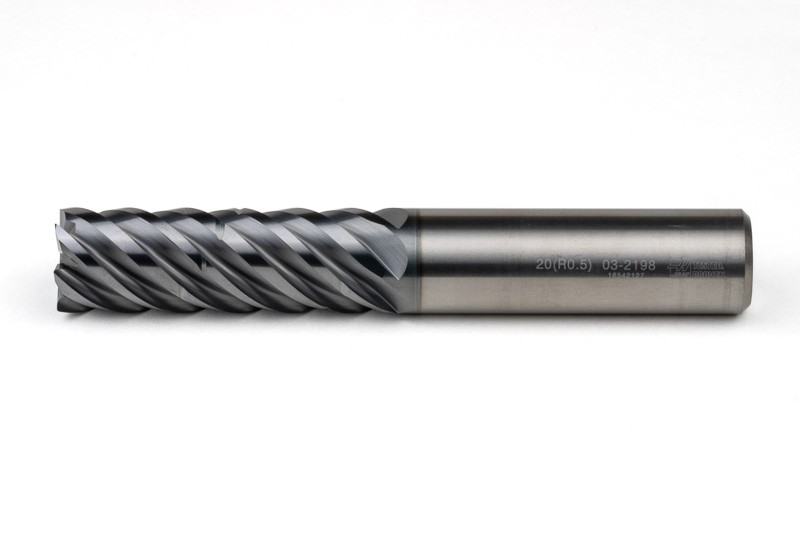

This HEPM 6-flute carbide end mill has a 20mm cutting diameter, with a 20mm weldon shank, 60mm length of cut (LOC), 0.5mm radius, and a 130mm overall length. It is hybrid AlCrN coated, and made to cut steel and stainless steel, but is capable of cutting some grades of cast iron and high-temp. alloys. This end mill is designed to center-cut.
ISO Material Chart
[ØDC] Cutting Diameter 20.0 mm
Haas Milling Series HEPM
Primary Workpiece Material M - Stainless Steel, P - Steel
Secondary Workpiece Material S - High Temp Alloys, K - Cast Iron
Material Carbide
Coating Hybrid AlCrN
Corner Type Radius
Shank Type Weldon
[ØDMM] Shank Diameter 20.0 mm
[LOC] Length Of Cut 60.0 mm
[OAL] Overall Length 130.0 mm
[NOF] Number of Flutes 6
[CHW\RE] Chamfer \ Radius Size 0.5 mm
[FHA°] Helix Angle 45
Cutting Direction Right
Center Cutting Yes
Variable Pitch No
Through Spindle Coolant No
Weight 2.5 lbs \ 1.1 kg
Country of Origin Various
