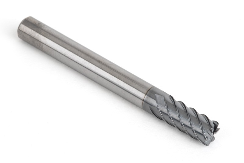

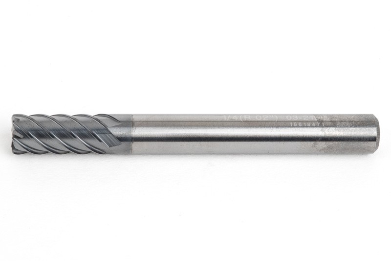

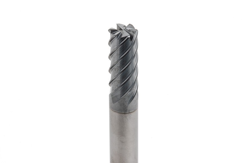

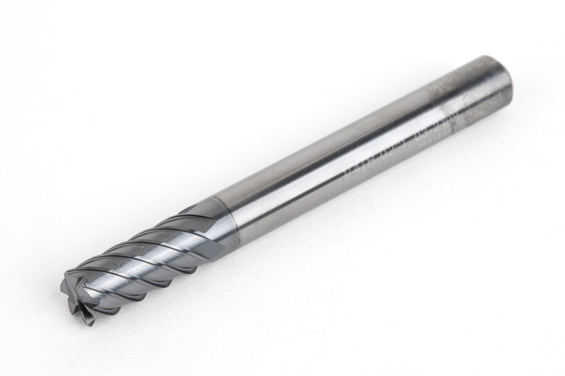

1/4" Dia. Carbide End Mill, 6 Flute, Hyb. AlCrN Coated, 1/4" Smooth Shank x 1/2" LOC, 0.02" Radius, HEHM
Part #: 03-2199
EM 6FL1/4(R.02)X1/4X1/2X2-1/4 ALCRN
Price: 29.95 ( / unit)
26.97
This HEHM 6-flute carbide end mill has a 0.25 in \ 1/4" cutting diameter, with a 1/4" smooth shank, 1/2" length of cut (LOC), 0.02" radius, and a 2-1/4" overall length. It is hybrid AlCrN coated, and made to cut steel, but is capable of cutting some grades of cast iron and hardened metals. This end mill is designed to center-cut.
ISO Material Chart
[ØDC] Cutting Diameter 0.25 in \ 1/4"
Haas Milling Series HEHM
Secondary Workpiece Material K - Cast Iron, H - Hardened Materials
Material Carbide
Coating Hybrid AlCrN
Corner Type Radius
Shank Type Smooth
[ØDMM] Shank Diameter 0.25 in
[LOC] Length Of Cut 0.5 in
[OAL] Overall Length 2.25 in
[NOF] Number of Flutes 6
[CHW\RE] Chamfer \ Radius Size 0.02 in
[FHA°] Helix Angle 45
Cutting Direction Right
Center Cutting Yes
Variable Pitch No
Through Spindle Coolant No
