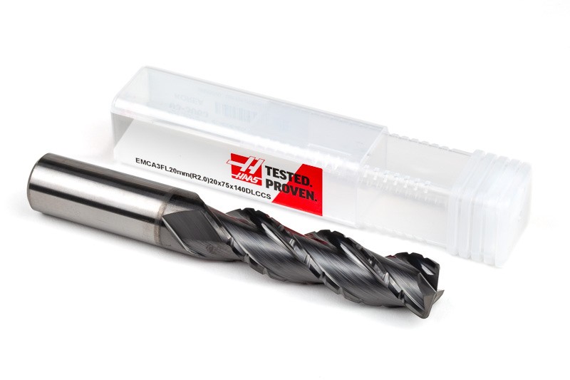

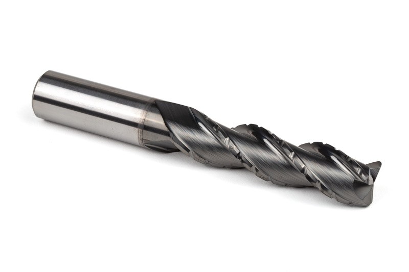

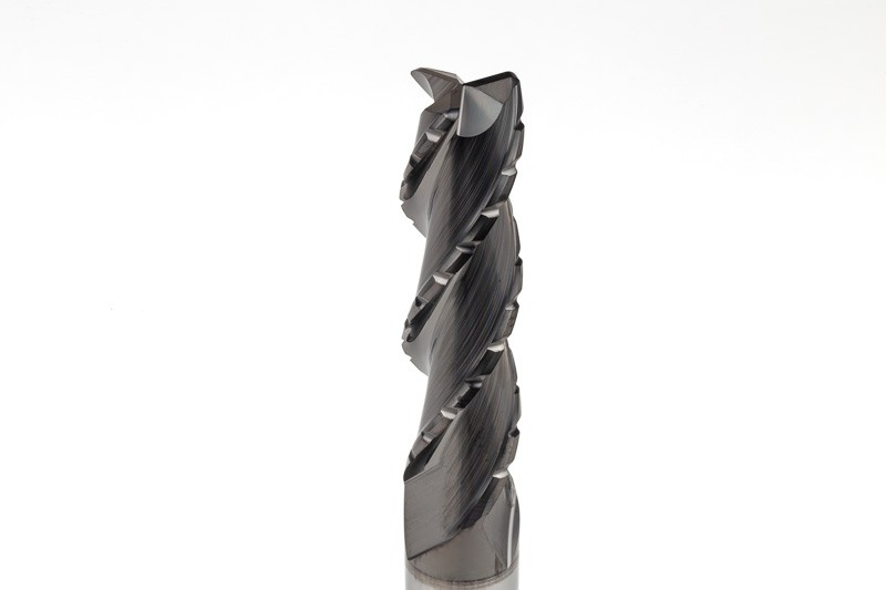

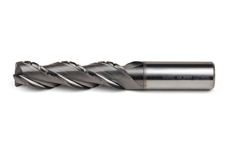

This HSAM2 3-flute carbide end mill has a 20mm cutting diameter, with a 20mm smooth shank, 75mm length of cut (LOC), 2mm radius, and a 140mm overall length. It is DLC coated, and made to cut aluminum/non-ferrous materials. This end mill is designed to center-cut.
ISO Material Chart
[ØDC] Cutting Diameter 20.0 mm
Haas Milling Series HSAM2
Material Carbide
Coating DLC
Corner Type Radius
Shank Type Smooth
[ØDMM] Shank Diameter 20.0 mm
[LOC] Length Of Cut 75.0 mm
[OAL] Overall Length 140.0 mm
[NOF] Number of Flutes 3
[CHW\RE] Chamfer \ Radius Size 2.0 mm
[FHA°] Helix Angle 37
Cutting Direction Right
Center Cutting Yes
Variable Pitch No
Through Spindle Coolant No
Weight 1.1 lbs \ 0.5 kg
