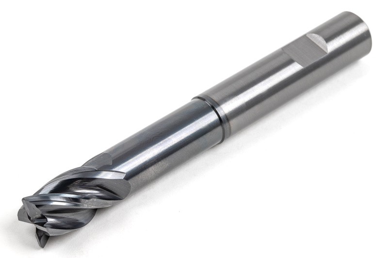

5/8" Dia. Long Carbide End Mill, 4 Flute, Hyb. AlCrN Coated, 5/8" Weldon Shank x 3/4" LOC x 2-1/2" Neck Length, 0.03" Radius, HTPM
Part #: 03-3082
EM4FL5/8(R.03)x5/8x3/4x2-1/2x5 HYB AlCrN
Price: 104.95 ( / unit)
94.97

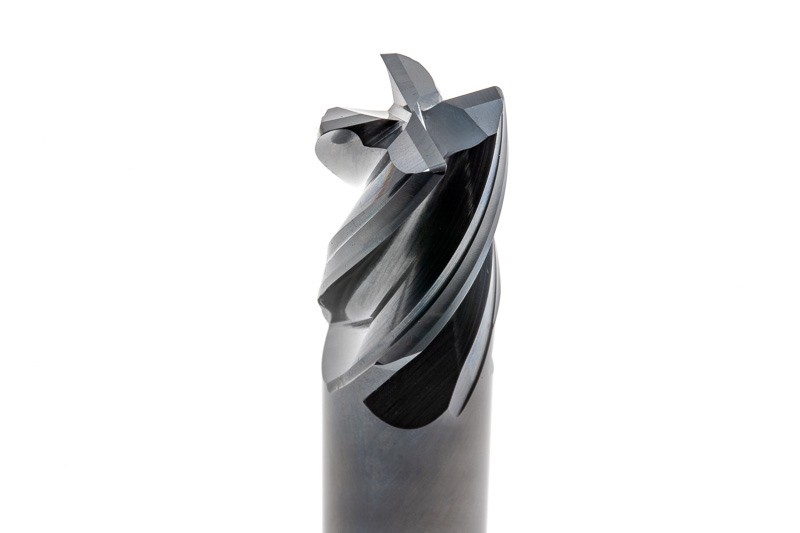

This HTPM 4-flute long carbide end mill has a 0.625 in \ 5/8" cutting diameter, with a 5/8" weldon shank, 3/4" length of cut (LOC), 0.03" radius, and a 5" overall length. The extended shank tapers down to a 0.586" neck diameter, with a 2-1/2" neck length. It is hybrid AlCrN coated, and made to cut steel, stainless steel, and cast iron, but is capable of cutting some grades of high-temp. alloys. This end mill is designed to center-cut, and the unique, variable pitch configuration helps to reduce unwanted harmonics and vibrations.
ISO Material Chart
[ØDC] Cutting Diameter 0.625 in \ 5/8"
Haas Milling Series HTPM
Primary Workpiece Material K - Cast Iron, M - Stainless Steel, P - Steel
Material Carbide
Coating Hybrid AlCrN
Corner Type Radius
Shank Type Weldon
[ØDMM] Shank Diameter 0.625 in
[LOC] Length Of Cut 0.75 in
[ØN] Neck Diameter 0.586 in
[LN] Neck Length 2.5 in
[OAL] Overall Length 5.0 in
[NOF] Number of Flutes 4
[CHW\RE] Chamfer \ Radius Size 0.03 in
[FHA°] Helix Angle 35/37
Cutting Direction Right
Center Cutting Yes
Variable Pitch Yes
Through Spindle Coolant No
Weight 0.6 lbs \ 0.3 kg
