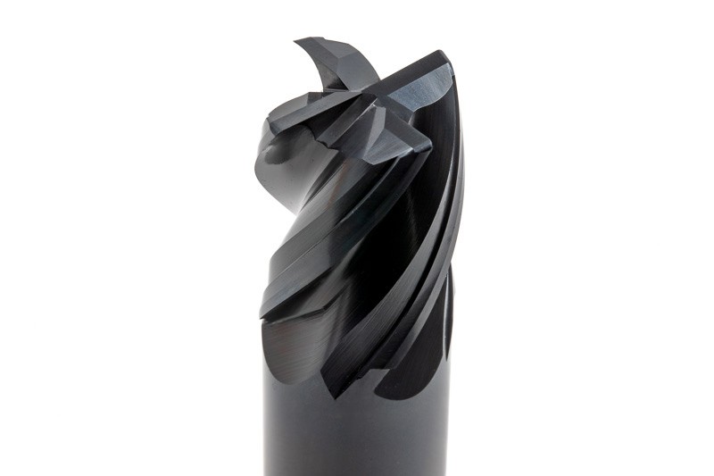

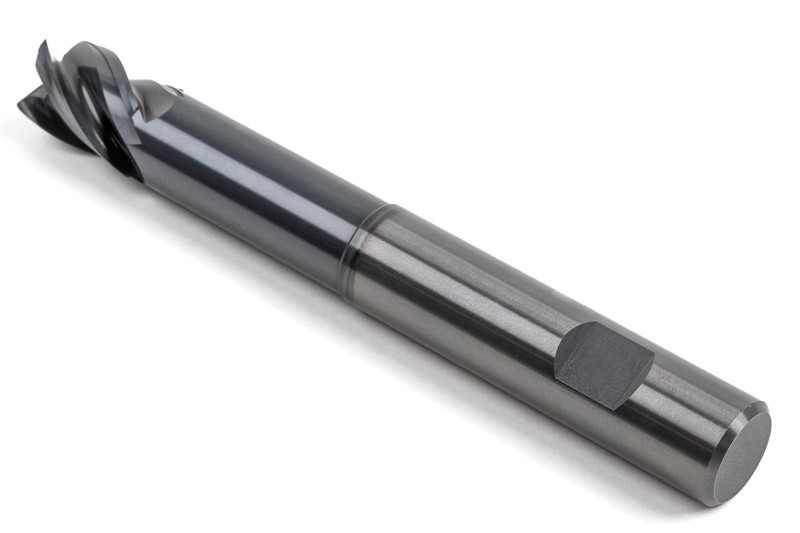

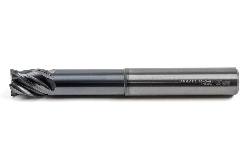

This HTPM 4-flute long carbide end mill has a 0.75 in \ 3/4" cutting diameter, with a 3/4" weldon shank, 1" length of cut (LOC), 0.03" radius, and a 6" overall length. The extended shank tapers down to a 0.711" neck diameter, with a 3" neck length. It is hybrid AlCrN coated, and made to cut steel, stainless steel, and cast iron, but is capable of cutting some grades of high-temp. alloys. This end mill is designed to center-cut, and the unique, variable pitch configuration helps to reduce unwanted harmonics and vibrations.
