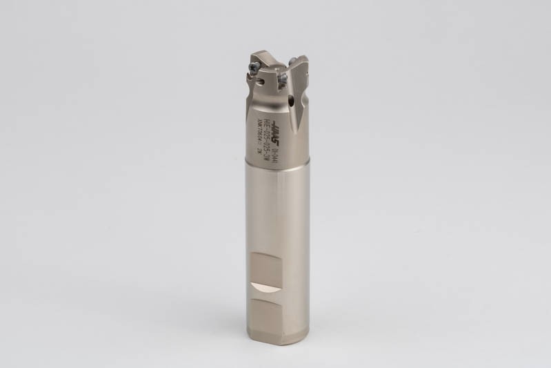

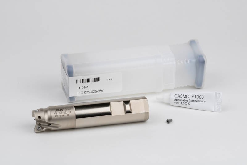

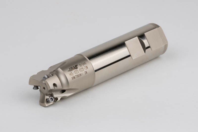

  • Technical Details
Milling Cutter Series HIE - Haas Indexable End Mill
Toolpath Type Face Milling, Shoulder Milling, Slotting, Axial Plunge Milling, Helical Milling, Ramping
Shank Type Weldon
[ØDC] Cutting Diameter 25.0 mm
[°] Lead Angle 90 Degree
[Z] Number of Cutting Teeth 3
[ØDMM] Shank Diameter 25.0 mm
[LH] Head Length 40.0 mm
[Ap] Max. Cutting Depth 5.5 mm
[OAL] Overall Length 115.0 mm
Maximum RPM 17000
Torque of Insert Screw 300 Ncm
Through Tool Coolant Yes
Weight 0.8 lbs \ 0.4 kg
