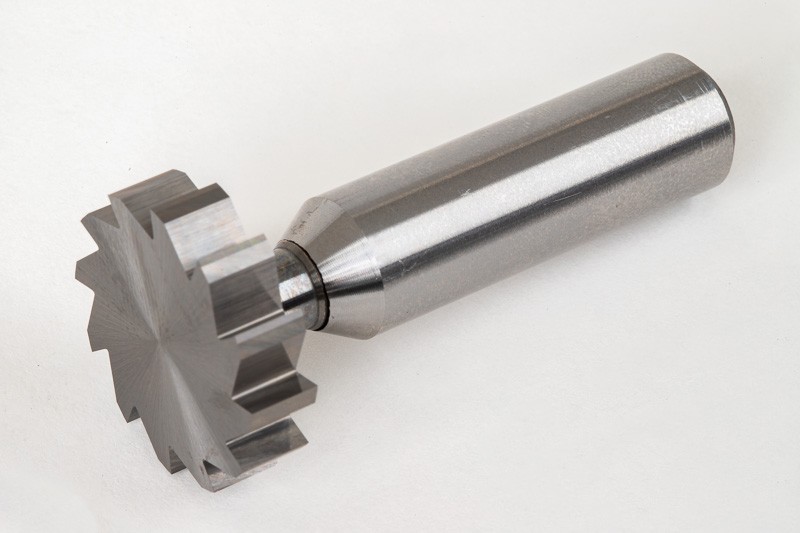

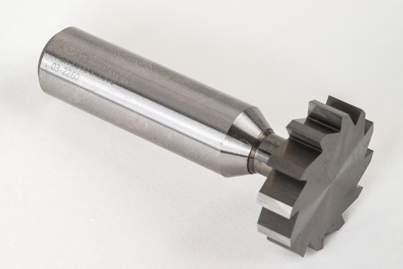

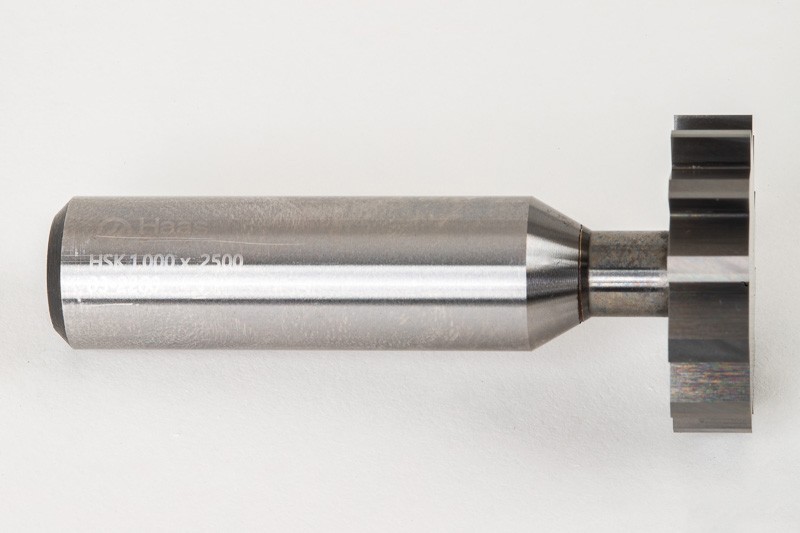

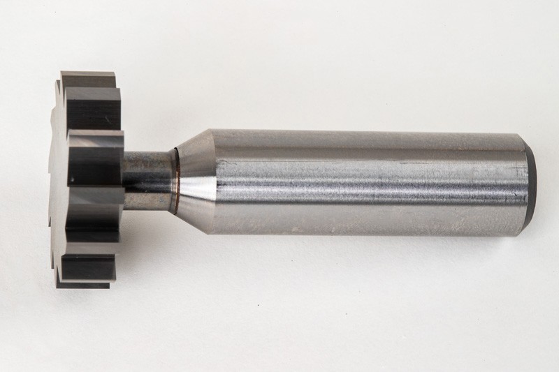

1" Dia. Carbide Straight Tooth Keyseat Cutter, 12 Flute, Uncoated, 1/2" Smooth Shank x 1/4" Cut Width
Part #: 03-2260
HKS 1.0000 X .2500
Price: 136.95 ( / unit)
109.97
This 12-flute carbide straight-tooth keyseat cutter has a 1.0 in \ 1" cutting diameter, with a 1/2" smooth shank, 1/4" cut width, and a 2-1/4" overall length. It is uncoated, and made to cut steel, stainless steel, cast iron, aluminum/non-ferrous materials, and high temp. alloys.
ISO MATERIAL CHART
Primary Workpiece Material K - Cast Iron, S - High Temp Alloys, N - Aluminum, M - Stainless Steel, P - Steel
Material Carbide
Coating Uncoated
Tooth Type Straight
Shank Type Smooth
[ØDC] Cutting Diameter 1.0 in \ 1"
Cutting Diameter Tolerance + 0.012 \ + 0.017 in
[ØDMM] Shank Diameter 0.5 in
[ØN] Neck Diameter 0.281 in
[CW] Cutting Width 0.25 in
[OAL] Overall Length 2.25 in
[NOF] Number of Flutes 12
Cutting Direction Right
Weight 0.3 lbs \ 0.2 kg
Country of Origin USA
