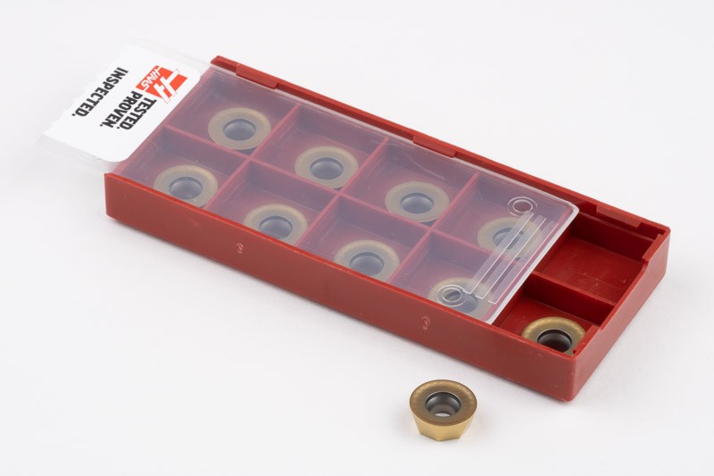

HRPP, Carbide Indexable End Mill Insert, Round, Grade HP25 - Pack of 10
Part #: 02-0967
RPMT1204M0S-HMM HP25

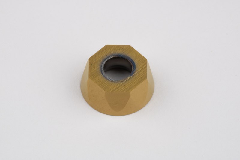

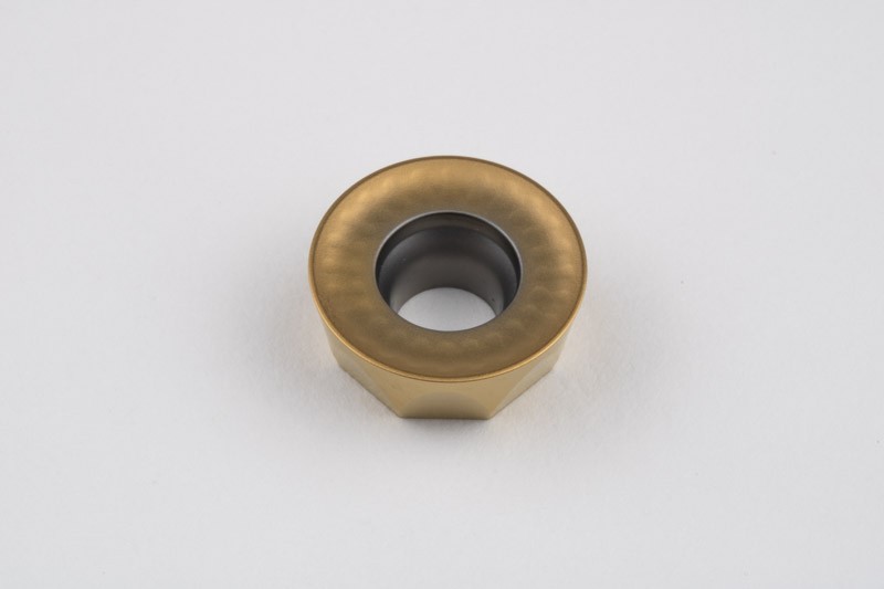

HRPP - High-Quality Surface Finish, Multiple Tool Path Insert
✓ Found in the Die and Mold Industry
✓ Can handle a maximum depth of cut upwards of .236 (5.99mm)
✓ High feed rates for quick removal of material
✓ Capable of face milling, shoulder milling, slotting, ramping, helical milling, and copy milling toolpaths
Insert Style
HRPP
HAAS ROUND POSITIVE POSITIVE
TOOLPATH TYPE
FACE MILLING, SHOULDER MILLING, SLOTTING, RAMPING, HELICAL MILLING, COPY MILLING
Round edge | D.O.C. max. .236 (5.99mm)
• Superior perpendicularity and minimized cutting loads
• Optimized for high-quality surface finishes
• High rake angle lowers cutting loads and minimizes burrs
• High-speed and high-feed capability improve productivity
Insert Grade
HP25
APPLICABLE WORKPIECE MATERIALS
● P - STEEL
Primary grade for steel. Excellent chip-removal rates, due to a tough substrate specialized for steel, and a PVD coating with high-hardness and good lubricity. Highly chip-resistant to provide good surface finish and extended tool life under various cutting conditions. This grade has a medium starting surface speed in steel, compared with the other grades.
HS Chip breaker: for machining with low cutting loads. Guarantees long tool life and accurate machining in light cutting, and machining heat-resistant super alloys.
MHS Chip breaker: for general milling.
●  Primary Workpiece Material | ○  Secondary Workpiece Material
TOOLPATH LEGEND
FACE MILLING
SHOULDER MILLING
SLOTTING
RAMPING
HELICAL MILLING
COPY MILLING
PLUNGE MILLING
CHAMFER MILLING
ISO MATERIAL CHART
Insert Style Round
Toolpath Type Face Milling, Shoulder Milling, Slotting, Ramping, Helical Milling, Copy Milling
Milling Cutter Series HRPP - Haas Round + / +
Grade HP25
Material Carbide
[IC] Inscribed Circle Diameter 0.472 in \ 12.0 mm
[INSL] Insert Length 0.472 in \ 12.0 mm
[RE] Corner Radius 0.236 in \ 6.0 mm
[D1] Insert Hole Size 0.177 in \ 4.5 mm
[Ap] Max. Cutting Depth 0.236 in \ 6.0 mm
[AN°] Clearance Angle 11
