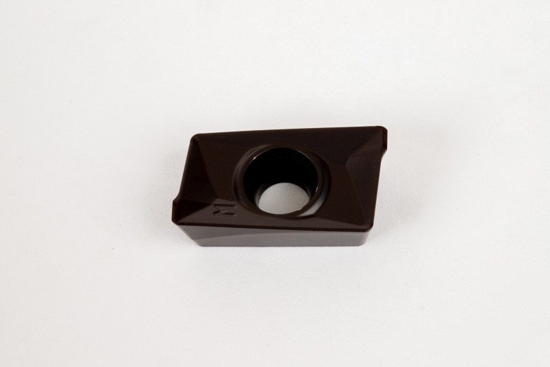

HAPN - Great Surface Finish Insert
✓ Provide great surface finishes thanks to their wiper geometry
✓ Positive axial rake, a negative radial rake, and 3D helical cutting edges
✓ Lower cutting forces and minimizes the load on the machine
✓ Capable of large depths of cuts while facing or shoulder milling
Insert Style
HAPN
HAAS PARALLELOGRAM POSITIVE NEGATIVE
TOOLPATH TYPE
FACE MILLING, SHOULDER MILLING
90° cutting edge | D.O.C. max .630" (16.00mm)
• Positive axial rake, negative radial rake.
• 3D helical cutting edge for lower cutting forces
• Wiper geometry for high-quality surface finishes
• Superior perpendicularity and minimized cutting loads

Insert Style Parallelogram
Toolpath Type Face Milling, Shoulder Milling
Milling Cutter Series HAPN – Haas Parallelogram +/-
Grade HP30
Material Carbide
[IC] Inscribed Circle Diameter 0.367 in \ 9.33 mm
[INSL] Insert Length 0.704 in \ 17.877 mm
[RE] Corner Radius 0.032 in \ 0.8 mm
[D1] Insert Hole Size 0.173 in \ 4.4 mm
[S] Insert Thickness 0.227 in \ 5.76 mm
[Ap] Max. Cutting Depth 0.63 in \ 16.0 mm
[AN°] Clearance Angle 11
