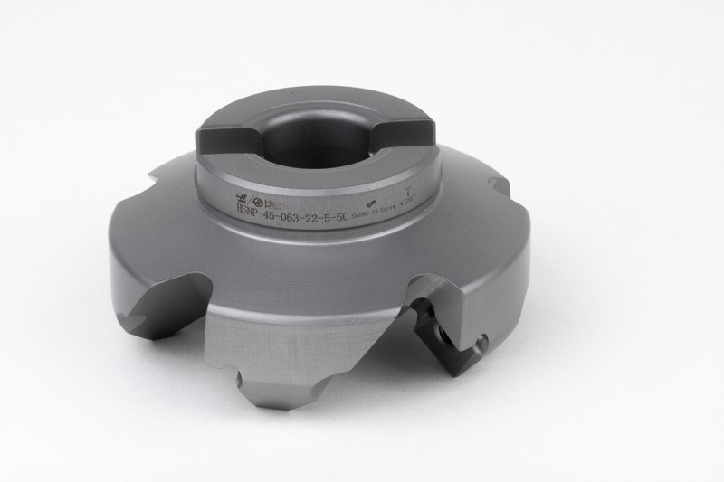

HSNP, 63mm Ø Shell Mill, 22mm Pilot Bore x 45° Lead Angle, 5 Flute, Negative/Positive Geometry, TSC
Part #: 01-0425
HSNP-45-063-22-5-5C
Price: 262.95 ( / unit)
Price: 2623.95 ( / unit)
Price: 780.95 ( / unit)
Price: 104.95 ( / unit)
Price: 472.95 ( / unit)
Price: 1101.95 ( / unit)
223.97
This Haas Square Negative Positive (HSNP) medium-pitch shell mill is an economical cutter that produces lower cutting forces and improved surface finishes due to its balanced geometry, as well as its thick, wiper-edge inserts. It is a superior choice for harder materials, specfically when face milling. It has a 63mm cutting diameter, and a 22mm pilot bore, with a 45-degree cutting edge. The negative axial, positive radial-raked cutter body takes 5 square cutting inserts. The screw-clamp inserts have 8 cutting edges, and are available in grades for steel, stainless steel, and cast iron. This cutter body is through-tool coolant (TSC) capable, when used in conjunction with a coolant-through arbor screw. Inserts and coolant-through arbor screw sold separately.
  • Speeds and Feeds
[ØDC] Cutting Diameter 63.0 mm
Milling Cutter Series HSNP - Haas Square - / +
Toolpath Type Face Milling
[ØDCX] Max Cutting Diameter 78.4 mm
[°] Lead Angle 45 Degree
[Z] Number of Cutting Teeth 5
[Ød] Arbor Hole Diameter 22.0 mm
[a] Keyway Width 10.4 mm
[Ap] Max. Cutting Depth 7.0 mm
[OAL] Overall Length 40.0 mm
Maximum RPM 1800
Torque of Insert Screw 670 Ncm
Coupling Style A
Through Tool Coolant Yes
Weight 1.3 lbs \ 0.6 kg
