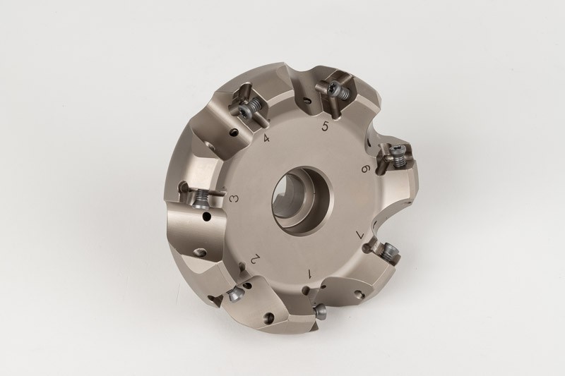

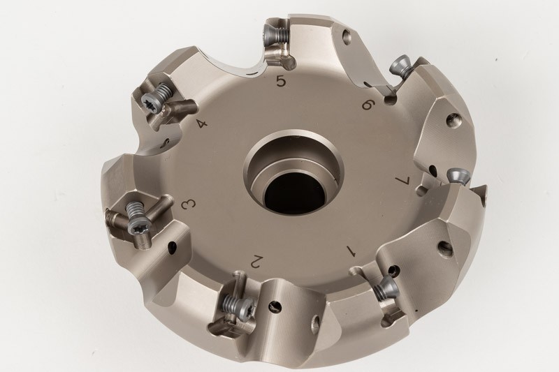

HCSNP, 3" Ø Shell Mill, 1" Pilot Bore x 45° Lead Angle, 7 Flute, Negative/Positive Geometry, TSC
Part #: 01-0610
HCSNPI4300-7
Price: 251.95 ( / unit)
This Haas Square Negative Positive (HCSNP) medium-pitch shell mill is an economical, highly durable cutter that produces lower cutting forces and improved surface finishes due to its high-rake, wiper-edge inserts. Its unique geometry excels in low-power machining applications across a wide range of materials, and is specifically designed for face milling. It has a 3.0 in \ 3" cutting diameter, and a 1" pilot bore, with a 45-degree cutting edge. The negative axial, positive radial-raked cutter body takes 7 square cutting inserts. The screw-clamp inserts have 8 cutting edges, and are available in grades for steel, stainless steel, cast iron, and aluminum/non-ferrous materials. This cutter body is through-tool coolant (TSC) capable, when used in conjunction with a coolant-through arbor screw. Inserts and coolant-through arbor screw sold separately.
[ØDC] Cutting Diameter 3.0 in \ 3"
Milling Cutter Series HCSNP - Haas Square - / +
Toolpath Type Face Milling
[ØDCX] Max Cutting Diameter 3.53 in
[°] Lead Angle 45 Degree
[Z] Number of Cutting Teeth 7
[Ød2] Diameter 2.2 in
[Ød] Arbor Hole Diameter 1.0 in
[a] Keyway Width 0.374 in
[b] Keyway Depth 0.248 in
[Ap] Max. Cutting Depth 0.236 in
[OAL] Overall Length 2.0 in
Maximum RPM 7000
Torque of Insert Screw 300 Ncm
Coupling Style A
Through Tool Coolant Yes
Weight 2.6 lbs \ 1.2 kg
