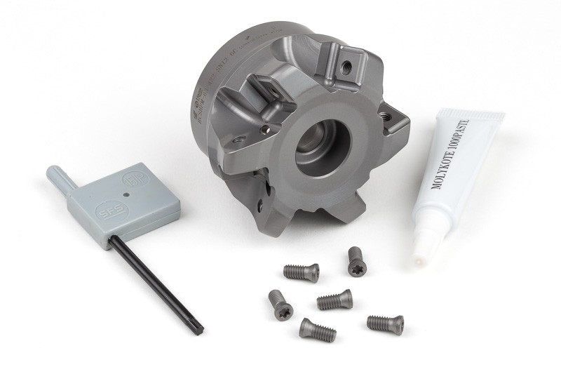

HCSHF, 63mm Ø Shell Mill, 22mm Pilot Bore x 17.23° Lead Angle, 6 Flute, High Feed, TSC
Part #: 01-0736
HCSHFM-63-A22-SN12-6C
Price: 270.95 ( / unit)
Price: 6448.95 ( / unit)
Price: 1919.95 ( / unit)
Price: 257.95 ( / unit)
Price: 1160.95 ( / unit)
Price: 2708.95 ( / unit)
243.97
5499.97
1636.97
219.97
989.97
2309.97

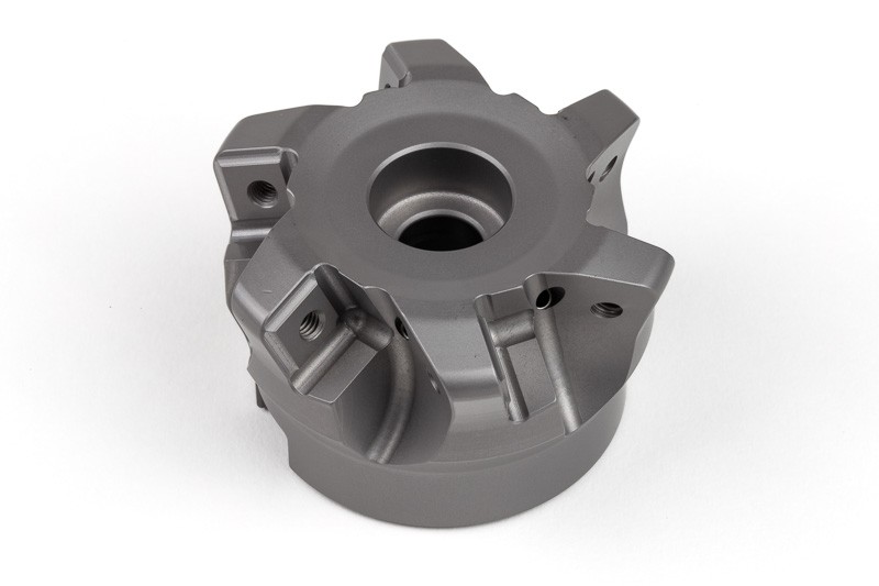

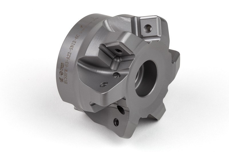

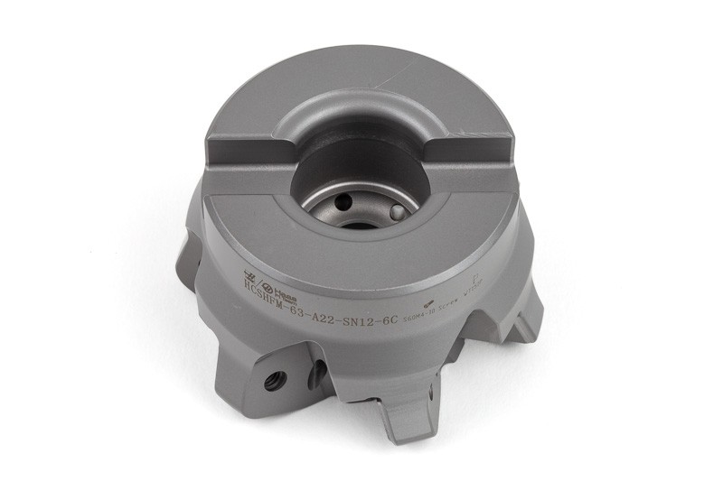

This Haas Double Square High Feed (HCSHF) medium-pitch shell mill is an economical, large-rake cutter with great vibration damping properties. The impact-resistant geometry allows for incredibly stable high-feed machining when axial plunge milling, copy milling, face milling, helical milling, and ramping. It has a 63mm cutting diameter, and a 22mm pilot bore, with a 17-degree cutting edge. The negative axial, negative radial-raked cutter body takes 6 square cutting inserts. The screw-clamp inserts have 8 cutting edges, and are available in grades for steel and stainless steel. This cutter body is through-tool coolant (TSC) capable, when used in conjunction with a coolant-through arbor screw. Inserts and coolant-through arbor screw sold separately.
[ØDC] Cutting Diameter 63.0 mm
Milling Cutter Series HCSHF - Haas Double Sq Hi Feed
Toolpath Type Axial Plunge Milling, Ramping, Helical Milling, Copy Milling, Face Milling
[°] Lead Angle 17 Degree
[Z] Number of Cutting Teeth 6
[Ød] Arbor Hole Diameter 22.0 mm
[E] Arbor Hole Depth 20.0 mm
[a] Keyway Width 10.4 mm
[b] Keyway Depth 7.1 mm
[Ap] Max. Cutting Depth 1.8 mm
[OAL] Overall Length 40.0 mm
[IC] Inscribed Circle Diameter 13.0 mm
[L10] Cutting Edge Length 12.7 mm
Maximum RPM 5000
Torque of Insert Screw 515 Ncm
Coupling Style A
Through Tool Coolant Yes
Weight 0.7 kg
