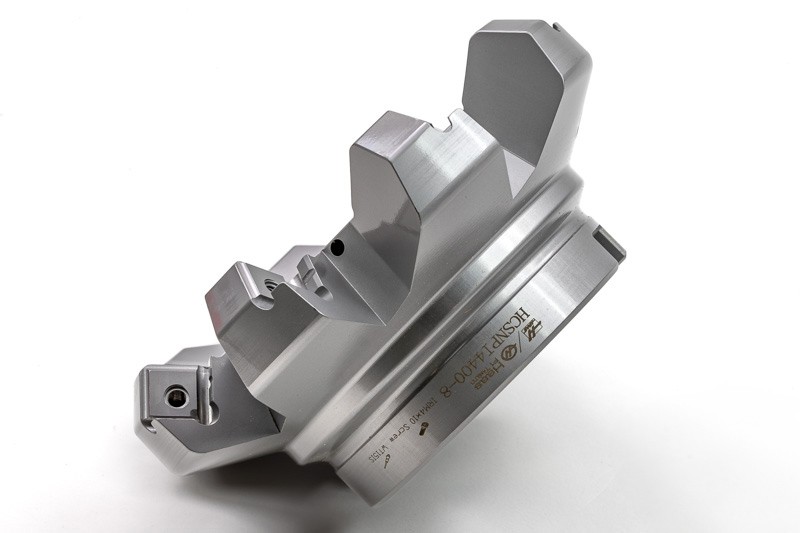

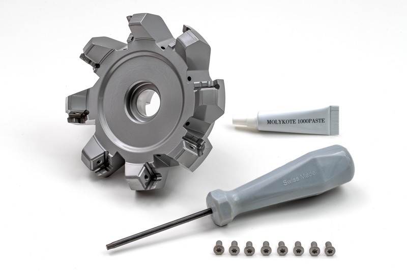

HCSNP2, 4" Ø Shell Mill, 1-1/4" Pilot Bore x 45° Lead Angle, 8 Flute, Negative/Positive Geometry, TSC
Part #: 01-0758
HCSNPI4400-8
Price: 419.95 ( / unit)
This Haas Square Negative Positive (HCSNP2) fine-pitch shell mill is an economical, highly durable cutter that produces lower cutting forces and improved surface finishes due to its high-rake, wiper-edge inserts. Its unique geometry excels in low-power machining applications across a wide range of materials, and is specifically designed for face milling. It has a 4" cutting diameter, and a 1-1/4" pilot bore, with a 45-degree cutting edge. The negative axial, positive radial-raked cutter body takes 8 square cutting inserts. The screw-clamp inserts have 8 cutting edges, and are available in grades for steel, stainless steel, cast iron, and aluminum/non-ferrous materials. This cutter body is through-tool coolant (TSC) capable, when used in conjunction with a coolant-through arbor screw. Inserts and coolant-through arbor screw sold separately.
[ØDC] Cutting Diameter 4.0 in \ 4"
Milling Cutter Series HCSNP2 - Haas Square - / +
Toolpath Type Face Milling
[ØDCX] Max Cutting Diameter 4.591 in
[°] Lead Angle 45 Degree
[Z] Number of Cutting Teeth 8
[Ød] Arbor Hole Diameter 1.25 in
[a] Keyway Width 0.625 in
[b] Keyway Depth 0.394 in
[Ap] Max. Cutting Depth 0.256 in
[OAL] Overall Length 2.0 in
[IC] Inscribed Circle Diameter 0.5 in
Maximum RPM 4500
Torque of Insert Screw 2.5 lb-ft
Coupling Style A
Through Tool Coolant Yes
Weight 0.9 lbs \ 0.4 kg
