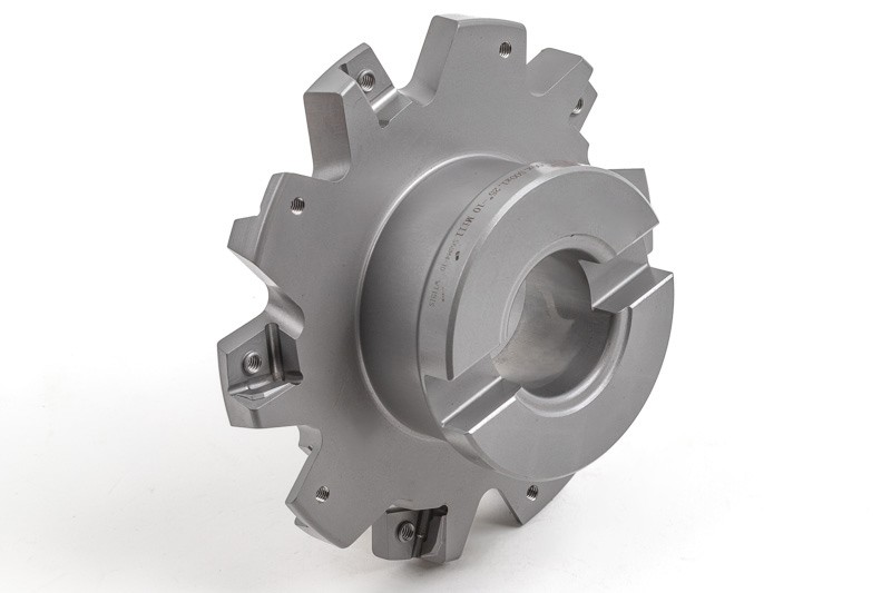

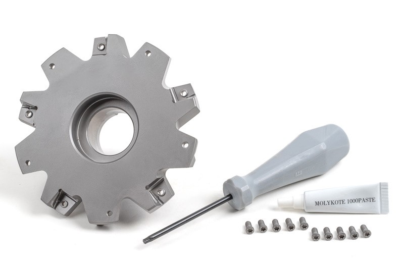

HSLPP, 5" Ø Slot Mill, 1-1/4" Pilot Bore x 1/2" Cut Width x 90° Lead Angle, 10 Inserts (LNGX1407), Positive/Positive Geometry
Part #: 01-0684
HCLPPI-5.00x.500x1.25"-10
Price: 509.95 ( / unit)
[ØDC] Cutting Diameter 5.0 in \ 5"
[CW] Cutting Width 0.5 in \ 1/2"
Milling Cutter Series HSLPP - Haas Slot + / +
Toolpath Type Slotting, Shoulder Milling, Face Milling
Type Pilot
[°] Lead Angle 90 Degree
[Z] Number of Cutting Teeth 10
[Ød2] Diameter 1.772 in
[Ød] Arbor Hole Diameter 1.25 in
[ØA] Head Diameter 2.521 in
[a] Keyway Width 0.5 in
[b] Keyway Depth 0.319 in
[Ae] Max. Radial Depth 1.2 in
[Ap] Max. Axial Depth 0.5 in
[LH] Head Length 1.21 in
[OAL] Overall Length 1.75 in
[IC] Inscribed Circle Diameter 0.524 in \ 13.32 mm
[L10] Cutting Edge Length 0.295 in \ 7.5 mm
Maximum RPM 1000
Torque of Insert Screw 3.4 Nm
Through Tool Coolant No
Weight 5.6 lbs \ 2.5 kg
