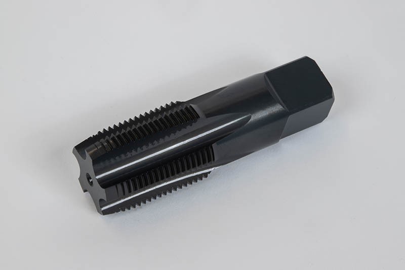

1"-11-1/2 NPS Straight HSS Pipe Tap, 1.125" Shank x 1.75" Thread Length, 5 Flute, Steam Oxide Coated
Part #: 03-0472
1"-11-1/2 NPS STEAM OXIDE
Price: 87.95 ( / unit)
61.97
1"-11-1/2 NPS Straight (Parallel) HSS Pipe Tap, 1.125" Shank x 1.75" Thread Length, 5 Flute, Steam Oxide Coated
ISO Material Chart
Primary Workpiece Material N - Aluminum, K - Cast Iron, P - Steel
Material HSS
Coating Steam Oxide
Thread Series NPS - Natl. Pipe Straight
Thread Size 1"-11-1/2
Tap Type Pipe Tap
Chamfer Type Plug
Shank Type Square
[TPI] Threads per Inch 11.5 tpi
Tap Drill Diameter 1.1406 in
[ØDC] Cutting Diameter 1.0 in
[ØDMM] Shank Diameter 1.125 in
[L2] Chamfer Length 4P-5P
[L1] Thread Length 1.75 in
[LU] Usable Length 1.75 in
[OAL] Overall Length 3.75 in
[SS] Square Size 0.843 in
[NOF] Number of Flutes 5
[FHA°] Helix Angle 0
Length / Diameter 2 X D
Through Spindle Coolant No
Weight 0.9 lbs \ 0.4 kg
