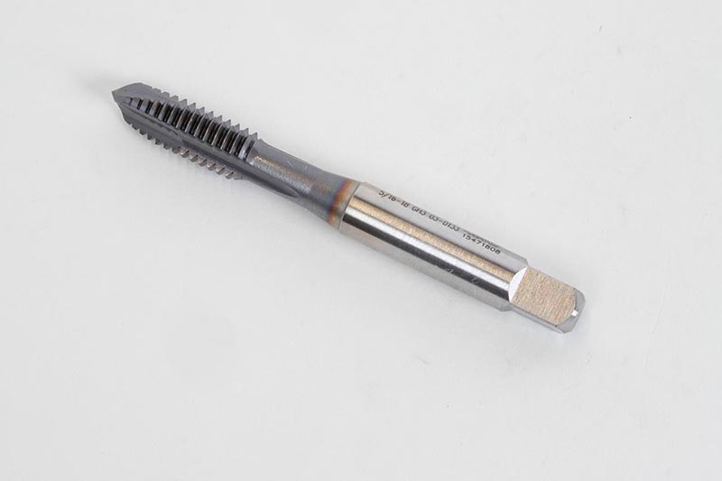

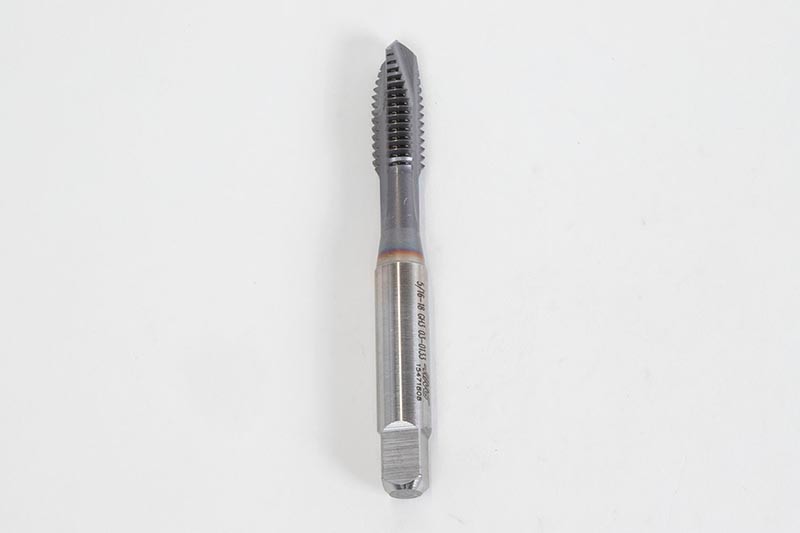

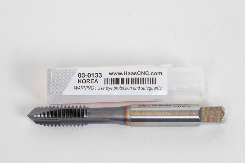

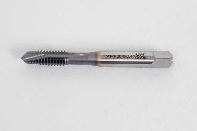

5/16"-18 UNC HSS-E Spiral Point Tap, 0.318" Shank x 0.669" Thread Length, 3XD, Plug, 3 Flute, GH3, TiCN Coated
Part #: 03-0133
5/16-18 SP PT MULTIPLE MATERIAL TAP
Price: 17.95 ( / unit)
12.97
TECHNICAL SPECIFICATIONS
ISO MATERIAL CHART
Thread Size 5/16"-18
Primary Workpiece Material P - Steel, M - Stainless Steel, N - Aluminum, K - Cast Iron
Tap Type Spiral Point
Chamfer Type Plug
Shank Type Square
Material HSS-E
Coating TiCN
[TPI] Threads per Inch 18 tpi
Tap Drill Diameter 0.26 in
[ØDC] Cutting Diameter 0.3125 in
[ØDMM] Shank Diameter 0.318 in
[L2] Chamfer Length 4P - 5P
[L1] Thread Length 0.669 in
[LU] Usable Length 1.126 in
[OAL] Overall Length 2.721 in
[SS] Square Size 0.238 in
[NOF] Number of Flutes 3
[FHA°] Helix Angle 0
Length / Diameter 3 X D
Thread Class GH3
Through Spindle Coolant No
