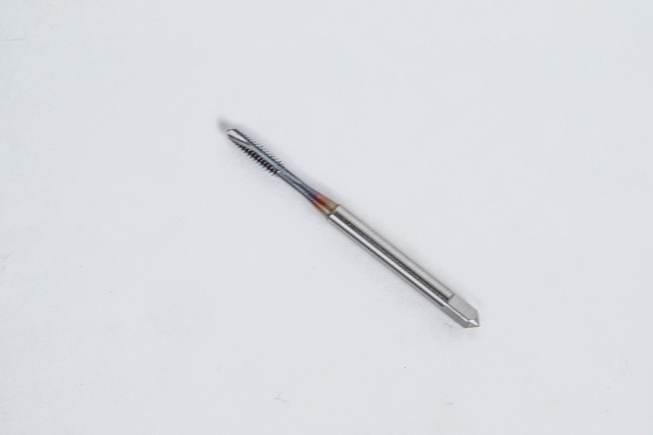

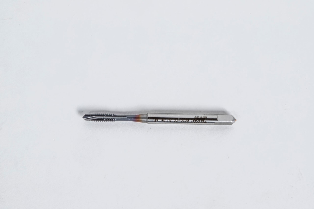

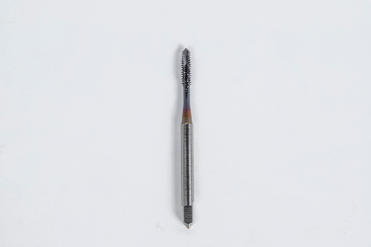

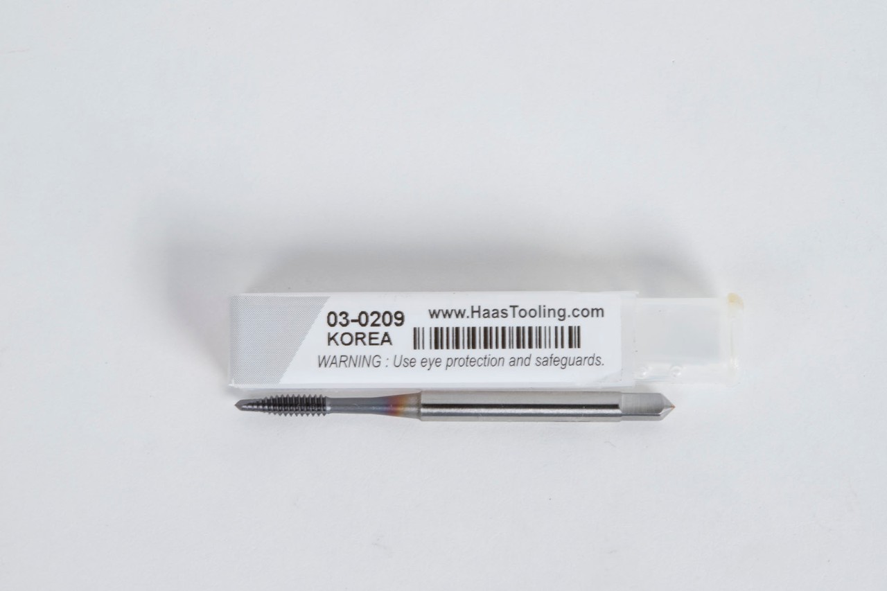

#4-40 UNC HSS-E Spiral Point Tap, 0.141" Shank x 0.335" Thread Length, 3XD, Plug, 2 Flute, H2, TiCN Coated
Part #: 03-0209
4-40 SP PT TI & NI ALLOY TAP
Price: 19.95 ( / unit)
12.97
ISO MATERIAL CHART
Thread Size #4-40
Primary Workpiece Material S - High Temp Alloys
Secondary Workpiece Material P - Steel, H - Hardened Materials
Tap Type Spiral Point
Chamfer Type Plug
Shank Type Square
Material HSS-E
Coating TiCN
[TPI] Threads per Inch 40 tpi
Tap Drill Diameter 0.091 in
[ØDC] Cutting Diameter 0.112 in
[ØDMM] Shank Diameter 0.141 in
[L2] Chamfer Length 4P - 5P
[L1] Thread Length 0.335 in
[LU] Usable Length 0.563 in
[OAL] Overall Length 1.874 in
[SS] Square Size 0.11 in
[NOF] Number of Flutes 2
[FHA°] Helix Angle 0
Length / Diameter 3 X D
Thread Class H2
