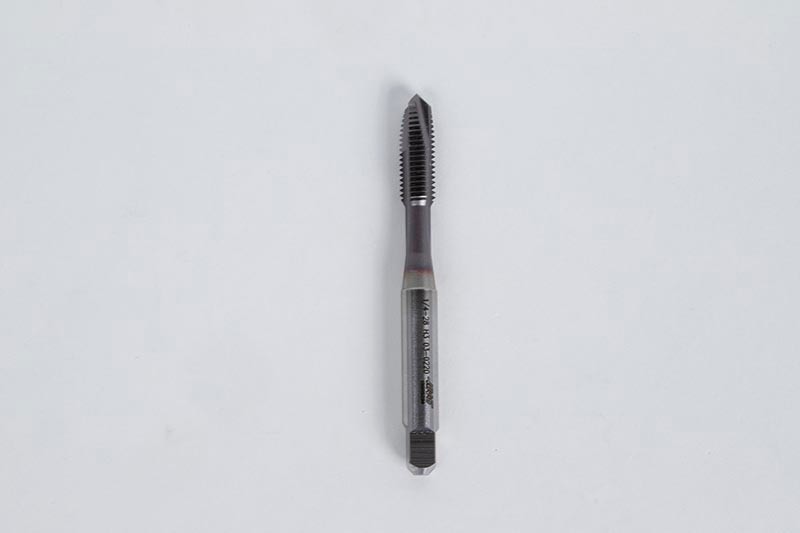

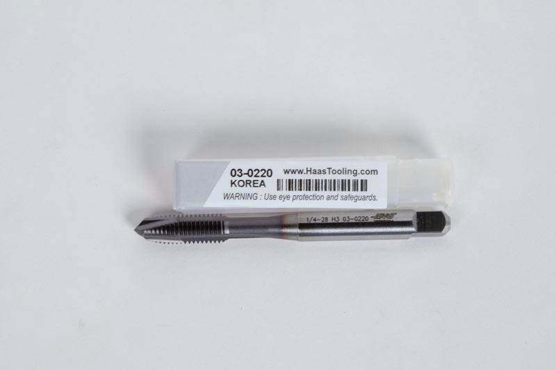

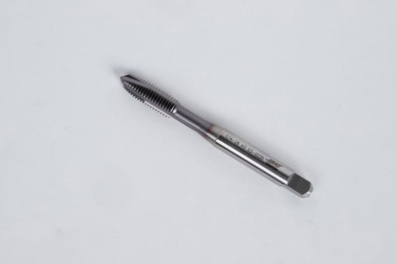

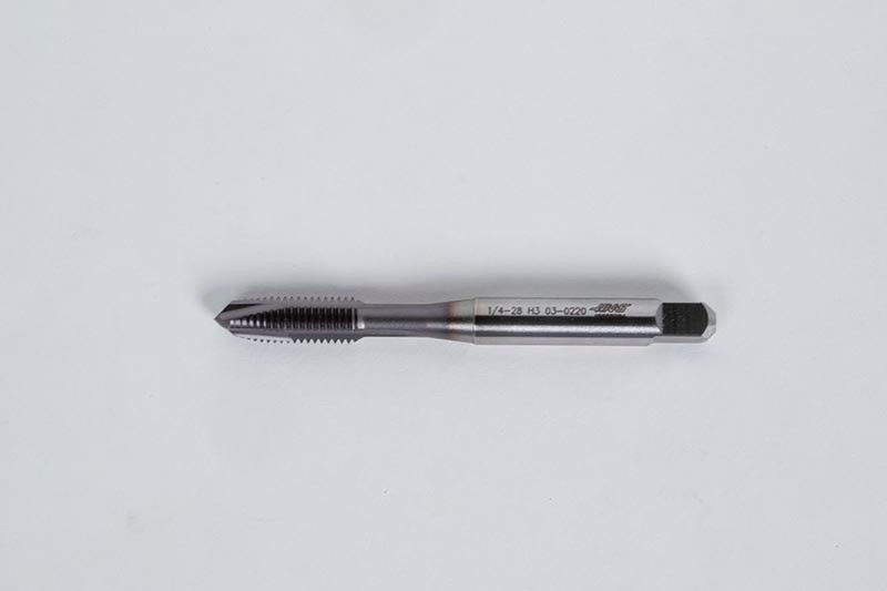

1/4"-28 UNF HSS-E Spiral Point Tap, 0.255" Shank x 0.591" Thread Length, 3XD, Plug, 3 Flute, H3, TiCN Coated
Part #: 03-0220
1/4-28 SP PT TI & NI ALLOY TAP
Price: 19.95 ( / unit)
13.97
This 1/4"-28 UNF (United National Fine) spiral point tap has a 1/4" thread size, with 28 threads per inch (TPI) and a 0.591" thread length. The 3-flute tap is constructed of high-vanadium high-speed steel (HSS-EX), and designed to cut threads in high-temp alloys. This is a plug-type tap, with an H3 pitch limit. It features a titanium carbonitride (TiCN) coating for improved wear, and resistance to built-up edge.
ISO MATERIAL CHART
Thread Series UNF - Unified Natl. Fine
Thread Size 1/4"-28
Primary Workpiece Material S - High Temp Alloys
Secondary Workpiece Material H - Hardened Materials, P - Steel
Tap Type Spiral Point
Chamfer Type Plug
Shank Type Square
Material HSS-E
Coating TiCN
[TPI] Threads per Inch 28 tpi
Tap Drill Diameter 0.217 in
[ØDC] Cutting Diameter 0.25 in
[ØDMM] Shank Diameter 0.255 in
[L2] Chamfer Length 4P - 5P
[L1] Thread Length 0.591 in
[LU] Usable Length 1.0 in
[OAL] Overall Length 2.5 in
[SS] Square Size 0.191 in
[NOF] Number of Flutes 3
[FHA°] Helix Angle 0
Length / Diameter 3 X D
Thread Class H3
Through Spindle Coolant No
