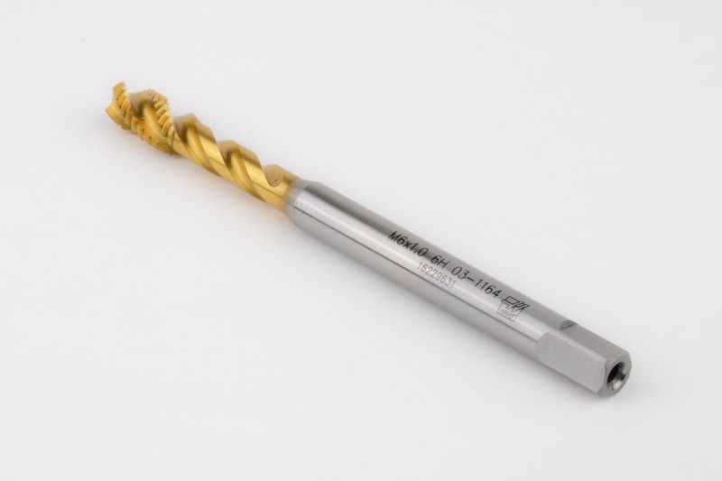

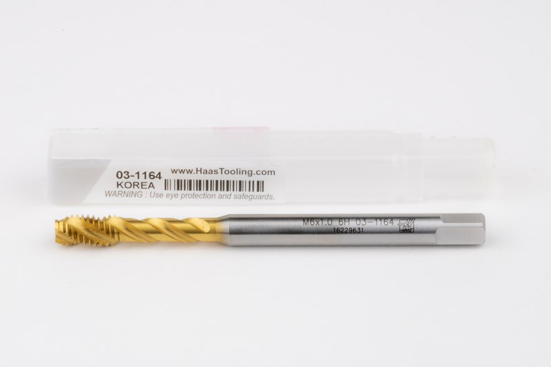

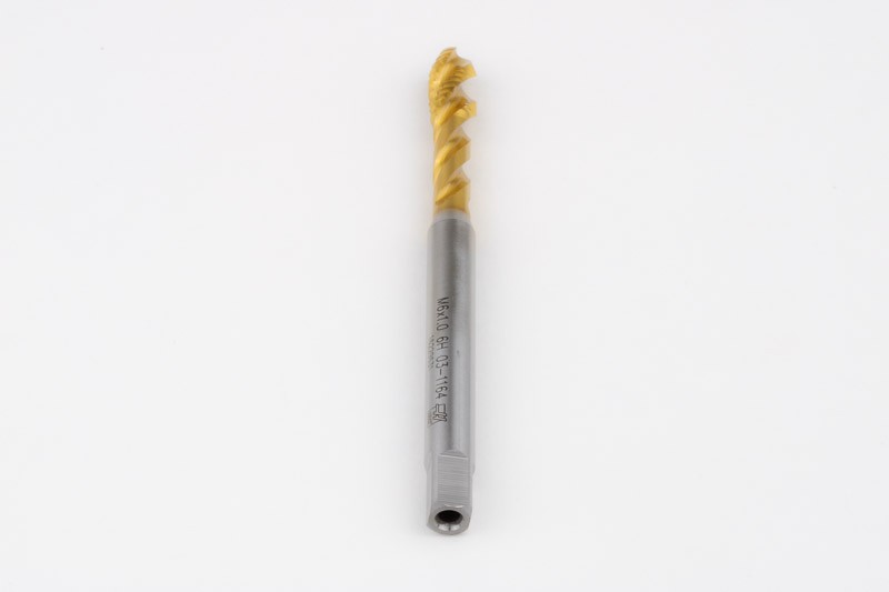

M6x1.0 M HSS-E Spiral Flute Tap, 6mm Shank x 10mm Thread Length, 2.5XD, Mod. Bottoming, 3 Flute, 6H, TiN Coated
Part #: 03-1164
M6 X 1 SP FL TSC MULTIPLE MATERIAL TAP
Price: 15.95 ( / unit)
Price: 198.95 ( / unit)
Price: 59.95 ( / unit)
Price: 7.95 ( / unit)
Price: 35.95 ( / unit)
Price: 83.95 ( / unit)
11.97
  • SPEEDS & FEEDS (INCH)
  • Speeds & Feeds (METRIC)
ISO MATERIAL CHART
Thread Series M - Metric
Thread Size M6x1.0
Primary Workpiece Material N - Aluminum, K - Cast Iron, M - Stainless Steel, P - Steel
Tap Type Spiral Flute
Shank Type Square
Material HSS-E
Coating TiN
[TP] Thread Pitch 1.0 mm
Tap Drill Diameter 5.0 mm
[ØDC] Cutting Diameter 6.0 mm
[ØDMM] Shank Diameter 6.0 mm
[L2] Chamfer Length 2P - 3P
[L1] Thread Length 10.0 mm
[LU] Usable Length 30.0 mm
[OAL] Overall Length 80.0 mm
[SS] Square Size 4.9 mm
[NOF] Number of Flutes 3
[FHA°] Helix Angle 40
Length / Diameter 2.5 X D
Thread Class 6H
Through Spindle Coolant Yes
