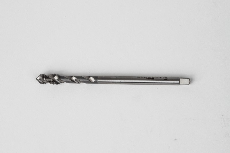

M7x1.0 M HSS-E Spiral Flute Tap, 7mm Shank x 10mm Thread Length, 2.5XD, Mod. Bottoming, 2 Flute, 6H, Uncoated
Part #: 03-1232
M7 X 1 SP FL ALUMINUM TAP
Price: 10.95 ( / unit)
Price: 148.95 ( / unit)
Price: 44.95 ( / unit)
Price: 5.95 ( / unit)
Price: 26.95 ( / unit)
Price: 62.95 ( / unit)
8.97
  • Speeds & Feeds (METRIC)
ISO MATERIAL CHART
Thread Series M - Metric
Thread Size M7x1.0
Secondary Workpiece Material P - Steel
Tap Type Spiral Flute
Shank Type Square
Material HSS-E
Coating Uncoated
[TP] Thread Pitch 1.0 mm
Tap Drill Diameter 6.0 mm
[ØDC] Cutting Diameter 7.0 mm
[ØDMM] Shank Diameter 7.0 mm
[L2] Chamfer Length 2P - 3P
[L1] Thread Length 10.0 mm
[LU] Usable Length 30.0 mm
[OAL] Overall Length 80.0 mm
[SS] Square Size 5.5 mm
[NOF] Number of Flutes 2
[FHA°] Helix Angle 45
Length / Diameter 2.5 X D
Thread Class 6H
